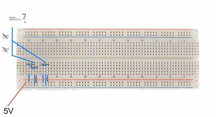

I am working on detecting fingers being placed on guitar frets. My idea is to run a small voltage through each of the strings, a different voltage for each string. The player touches the string and makes the string touch the fret. On the end of the fret I detect the voltage with an Arduino (analog input). Since each string has a different voltage, the system can detect which string is touching the fret. So far, so good. But when two strings touch the same fret, I don't get the addition of the two voltages. The voltage goes down. How would I go about to solve this? How do I add voltages or detect multiple strings touching a fret?
I am using a 5V input and then using resistors as voltage dividers to get the different voltages for each string. See schematics attached.
Correct, you simply short together two voltage sources.
Sorry but basically this is a flawed idea, and it will not work.

The only solution I think is to split each fret into six separate sections and wire that up, but that is a lot of wires. The wires from each sub fret would go into a conventional voltage summing circuit using an op-amp.
You might, possibly, maybe be able to get something to work if you put different values of resistors in series with each string then measure the resistance in contact with the fret. You would need to choose resistors so as to give unique values for every possible combination of strings. Do a search for R 2R resistor ladder.
I am suggesting this as a highly speculative idea, I've not thought it through properly and I certainly have not tried it.
