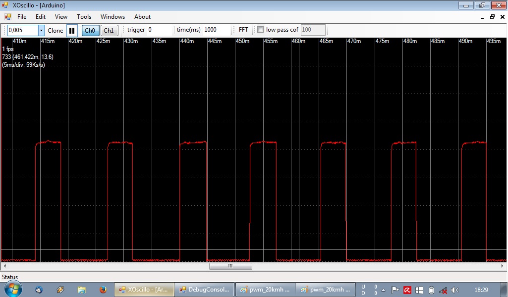

Maximum pulse width is infinite, when the car is standing still. Minimum pulse width goes towards 1 ms, perhaps less, at highway speed. But my system isn't supposed to do anything anyway at higher speeds.
The "interesting" pulse widths for my purposes are 50 ms at 12 mph,
and 115 ms at around 5 mph. I've figured them out by putting the car on a lift and accelerating in forward gear, with an oscilloscope hooked up to the speed signal.
Here's a snapshot of what the speed signal actually looks like:
I've replicated the signal using another Atmega328P-PU on a breadboard by means of simple HIGH/LOW bit banging. I can manipulate the pulse length with an analog rotary pot. This signal is fed into my standalone circuit to mimic the real thing.

Ok, so I put in a "lab day" today and hooked up my circuit and a number of Arduinos and breadboards to my car.
For the flat-12V reverse signal, a high resistance setup seems to work. I've fed 12 volts from the car battery into the Atmega using a 30k/12K voltage divider, and the Atmega picks it up, no problem. I suspect that voltage spikes will be more likely on the reverse gear signal than elsewhere.
With the speed signal, I've had no luck with any kind of setup with "big" resistors. The speed signal just seems to be too weak for anything in the tens of kiloohms. So then I connected the Atmega to the speed signal with a 5K rotary pot, and that's the only thing that gave me a signal that the Atmega picked up. I'll try again tomorrow with a breadboard voltage divider using 1K and 0.5K resistors. Even at 16-volt spikes, it will put no more than 5.33V onto the Atmega's input pin.
