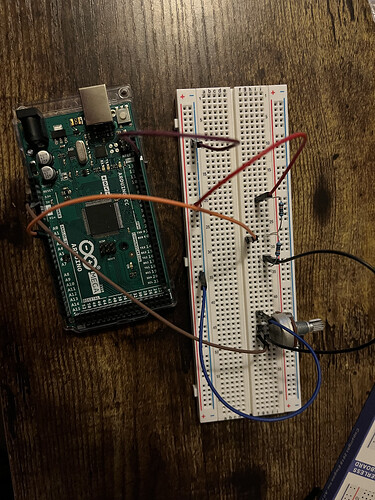

Hello,
Today I was attempting to use a voltage divider to reduce the output (0-5v) voltage of a potentiometer in half. From my understanding, the equation for a voltage divider shows that using two equivalent resistors in series will accomplish this. However, when I try this with my Arduino the voltage is not half (varies depending on the equivalent resistor values). Could someone please help me with this, or let me know if im missing something (Mech-e here)? My code for reading voltage is below, as well a picture of my wiring.

The potentiometer IS a voltage divider. Why do you need another one?
Voltage dividers wired in series or parallel do not follow the "ideal" behavior of a single voltage divider. The entire circuit has to be analyzed to determine the output voltage.
See this example of a voltage divider with load resistor: Voltage Divider
When you calculate the voltage of a divide you have to include in your calculation whatever resistance is on the "output" (aka the center node of your divider). My guess is you have not.

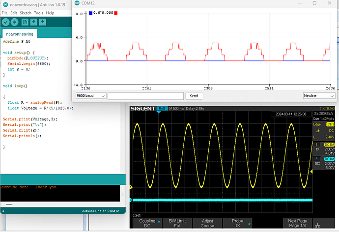

I wasn't sure either, so I did a test.
I used a 1Hz, 10V pk-pk sinewave, (Yellow oscilloscope trace).
The potential divider was made from 2 x 10kΩ resistors.
The junction of the two resistors went to the analogue input and also the blue oscilloscope trace.
There is hardly any signal seen on the blue trace of the oscilloscope, and the ADC count didn't get any higher than 3.
and here is the result with 'pinMode(P, OUTPUT)' commented out:
The potential divider now works correctly. 5V peak to peak signal on the blue trace, and ADC count >1000.
So it looks like that it is the:
pinMode(P,OUTPUT);
that is the cause of your problem.
Just remove that line and every thing should work correctly. There is no need to declare the pin as an INPUT, it automatically defaults to input if you don't specify anything.
