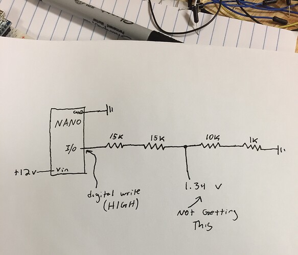

so i am trying to use the 5V siginal from an arduino nano to supply a voltage divider to drop the voltage down for an optocoupler. I've done the math and i need a 30K resistor and an 11k resistor. For whatever reason i'm getting mV out. Iv used my multi-meter to probe around and check resistance and for something pretty basic i'm lost.

draw the schematic on a blank sheet of printer paper, take a photo and post it.
Assuming 30 + 1 dropper on the output you will get 160mV across the 1k resistor IF there is no further load
However if there is any load applied across the 1k resistor then its effective value in the dropper chain decreases and so does the voltage across it.
As previously poster stated, provide a sketch of your circuit (not a picture or drawing of breadboard and components)
image attached
WHAT I/O ?
ive tried 12 and 4 and even just the 5v pin
With the 15Ks,10K, and 1K, the voltage should be right: 5V * (10000 + 1000)/(10000 + 1000 + 15000 + 15000) = 1.34V
What does that have to with an optocoupler tho? Optocoupler is just an LED, use a 220 ohm resistor in series with the optocoupler's LED to drive ~ 20mA thru it and turn on the output resistor.
says that the max input voltage is 1.35 typical for the optocoupler
Make sure you have pinMode (pinX, OUTPUT); as well, otherwise you won't get much current from an IO pin, it'll be like driving the pin thru a 30K resistor:
5V* (10000 + 1000)/(10000+1000 +15000+15000+30000) = 0.77V

See, page 3 shows characteristics with If or 5, 10, 20mA. Use 220 as I suggested, LED side wired per upper left of sheet 4.
