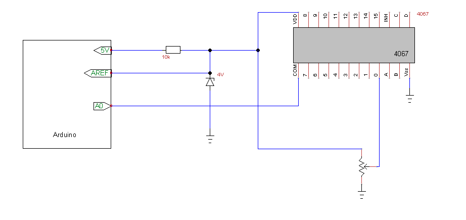

I didn't notice anywhere in the commentary above the possibility of using the ARef pin, and declaring
analogReference(EXTERNAL) in your setup code.
I've dealt with varying power supplies, from about 5 v. to 4.75 v., and this much change seems to be tolerated by the Arduinos. But if you want a reliable voltage reference in these circumstances, use a zener diode, at, say a little over 4 v. for a voltage reference(in series with say a 10K resistor), and hook that to AREf. Varying supply voltage will still have a small effect, but it will be much more stable. There are specific highly stable voltage reference chips out there also which can hold a very close reference voltage.
Is this schematic correct if I use a 4067? If I use this approach, do you think the Potis need smaller R-values?
The current into Aref alone drops the voltage across the zener below 4volt.
"...there is an internal 32K resistor on the AREF pin."
I guess 16 10k pots are used. That's 625ohm. Plus the IC.
Not a task for a simple 4volt zener.
Read post#14 again.
Why the 4067. A Mega has 16 analogue inputs.
Give us the whole story, including diagram and code.
