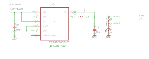

Can anyone see the issue with my circuit voltage regulation? Any help would be amazing, thanks in advance.
I chose to use this step down regulator, TPS62291DRVT. I have a circuit running at 3.3v by battery and it is pulling around 600mAh.
Data sheet: http://www.ti.com/lit/ds/symlink/tps62290.pdf
I found this circuit on the data sheet which isn't working on my PCB at all and am not sure where I have gone wrong: http://25.media.tumblr.com/dea207a1bebe3b7540e357b27afe41e3/tumblr_mt2ajmtC7i1so48cuo1_500.png.
Here is my circuit and PCB:
PCB image: http://31.media.tumblr.com/e061d5e1ebe186f75b36704477860d04/tumblr_mt2am1vNTh1so48cuo1_500.png
This was the inductor I used: http://uk.farnell.com/wurth-elektronik/74479775222/inductor-pmi-0805-2-2uh-0-7a-20/dp/1869750?Ntt=1869750
At the moment, when I power the circuit with 6V the output I get is 0.75mAh.

In the circuit diagram there is a component labeled L1.
I interpreted that as an inductor and used this http://uk.farnell.com/wurth-elektronik/74479775222/inductor-pmi-0805-2-2uh-0-7a-20/dp/1869750?Ntt=1869750.
Was that correct??

That inductor is rather small for a switching power supply. There is a good chance that it is saturating.
I'm unsure what the OP is saying. Are you saying that the circuit is drawing 600mA with no load attached? Or that it is drawing 600mA from the power source, while only outputing 0.75mA (not mAh) to the LED? What is the color of LED? What forward voltage is it rated at?
Use the TPS62290. See the first circuit in the datasheet? Replace R1 with the LED, and use a value of R2 that will pass the required LED current with 0.6V dropped across it. In that way, you are regulating the current rather than regulating the voltage while hoping that the voltage drop due to increasing temperature doesn't cause current to increase too much.
And use an L1 rated at least 2A.
Are you using the specified 10uF 6.3V chip ceramic capacitors? Or did you just wang in some aluminum electrolytics?

I'm not sure about your choice of L1, it is rated at .7A, it should be okay for your application. The current rating also dictates the DC resistance of the inductor, but I don't think in this case it has any effect on getting the chip started or regulating.
Tom 8)
Also your PCB image tells me nothing as you have not included an overlay to identify even the IC and inductor.
For example pin2 and pin 6 should joined together with the thermal pad, where is this on your pcb image?
