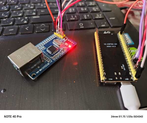

Hello. I have been trying to connect my ESP32-S3 (No PSRAM varient) to the internet using the W5500 ethernet module. I am using the standard W5500 chinese module. I have tried several different libraries. The one which did work for me is the LilyGO-T-ETH-Series one (I am attaching the code). So it does connect to the internet using this code occasionally, that too when I fiddled with the jumper wires. However, I did triple check the wires with the multimeter if any of them were broken from the inside. I also checked the header pins of my ESP and the W5500 as well if they were loose. I also tried powering up my W5500 module with a buck converter because I read somewhere that ethernet modules can be power hungry and the first time it worked was when it was hooked up to a buck converter. I am testing the code on the Arduino IDE 2.3.3 and ESP32 Core version 3.0.5.

The pins I am using for the connections are:
W5500 <--> ESP32-S3
MISO <--> 11
MOSI <--> 12
SCLK <--> 10
CS <--> 9
INT <--> 13
RST <--> 14
Any ideas as to where I might be going wrong or what I can check to debug my issue. I am happy to answer anymore questions that might required for the debugging.

with the ESP32-S3-DevKitC-1 and W5500 I used the EthernetESP32 library
connections
// ESP32_S3_DevKit_1 connections
// ESP32_S3 SCK pin GPIO12  to W5500 SCK
// ESP32_S3 MISO pin GPIO13  to W5500 MISO
// ESP32_S3 MOSI pin GPIO11  to W5500 MOSI
// ESP32_S3 SS  pin GPIO 10   to W5500 SCS
running File>Examples>Ethernet32>HelloServer I get
Initialize Ethernet with DHCP:
  DHCP assigned IP 192.168.1.70
MDNS responder started
HTTP server started
and the web client displays
I tried the example you pointed out with the SPI pins you used, but it fails to initialize for me. I did comment out the LED variables since it was initalized on GPIO13 but no luck. I guess, I should try it with a different W5500 module. This one might be damaged.
Did you use any external power supply for the W5500 or just powerd it up from the ESP?
I powered it from the ESP32S3 module 3.3V supply - photo
I seem to remember I had another W5500 module which did not work with the ESP32S3
can you upload a photo of your configuration?
I hope this gives you an idea
with my EthernetESP32 use the default SPI pins from pins_arduino.h for the selected board, or use SPI.begin before Ethernet.init to specify the SPI pins. third option is to create an SPI object and provide it to Ethernet as shown in README
Thank you for your response
It turns out there was some issue in the module. Even though the SPI communication was initializing, it wasnt working. I went out and bought another one and it worked. Lesson reiterated: Always buy 2 of everything just incase :slightly_smiling_face:
