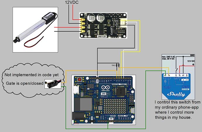

I have an Arduino Uno R4 wifi that I want to control a motor that will lock a gate.
Right now I have a small problem that I think someone can help me with.
I haven't gotten that far but, I get the motor to go in the right direction at the right time.
My problem is that when restarting the program and my Pin5 is high, the program runs the lock statement, I want the program to wait for an event.
If my Pin5 is low when restarting, the program waits until I change the pin to high.
Can I get the program to wait for an event when restarting, regardless of the current state?

What caused Pin 5 to be HIGH after restart?
Is this an emergency situation for your lock mechanism and if so, is it necessary to take any action to eliminate it?
My switch that I use to control the lock is either open or closed, so I can't eliminate this.
Think about how you are initializing lastButtonState.
This should not be the case, this is a sign of bad design.
The system must be designed so that upon restart the pin is always in a known position.
By the way, why do you need a duplicate variables for Pin5 state?

Hint: if you just want to wait changing Pin5 state - it's simple. Read the state upon restart and do nothing until the state changed.
Global variables are by default initialized to zero, if I recall correctly. So you change would not have made any difference.
Think some more. It's literally a one line change to make it work if the button starts off LOW or HIGH.

Shelly and R4 wifi. You need 2 wifi connected devices?
The initial value of 0 for lastButtonState means you've stored the value it has when the switch is open.
int latButtonState = 0;  // would be zero anyway
This suggestion
is to initialise that variabke in your setup()function instead, by actually reading the switch. So if the switch is closed, so is your idea of what is the last button state, it is adjusted to reflect the startup condition of the switch.
HTH

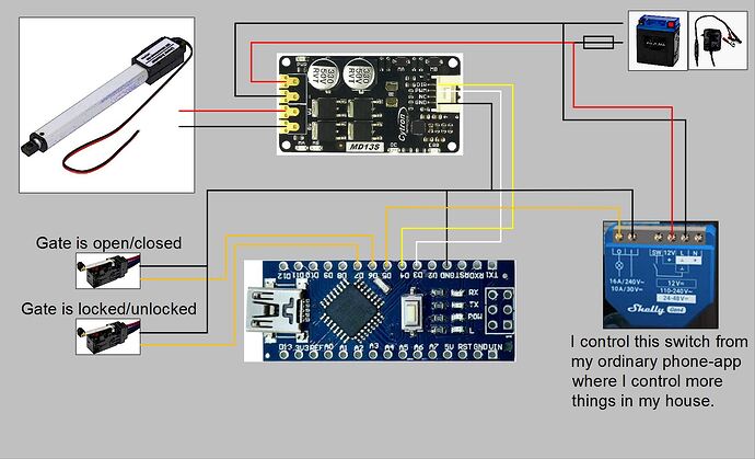

Hey,
Now I want to show what I have managed to do, as the cut and paste coder I am, with the help of Microsoft Copilot I can also succeed! Now I have managed to do two things:
  1. My little project looks good and will most likely work.
  2. I have used Copilot for the first time, we became really good friends :smiley:
I understand that some of you do not think it is an achievement to use Copilot, but even though Copilot did a lot, I have also learned a little. I can recommend trying it if you are stuck due to lack of knowledge.
If anyone can benefit from this code, in whole or in parts, please do!
Best regards.

So… I don't have enough whatever left today to figure out what your code does.
It will lock and unlock on your signal if the gate is closed. But what opens and closes the gate?
Where are the roller switches in the mechanism that uses the linear actuator? Is that actuator running the lock or the gate or what?
As for how you did it, I say success is hard to argue with. At the very least you managed to keep Copilot focused long enough to succeed, but I must point out you needed some real help as well.
