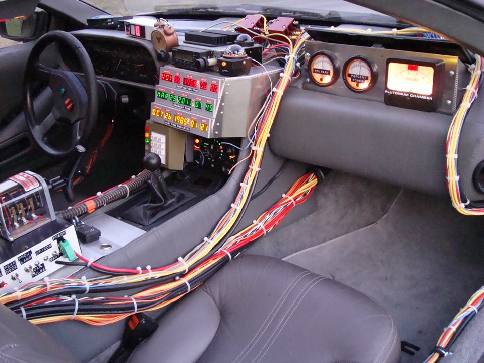

This instrument panel on the right ?
You may be able to purchase the whole car for around $100,000 or maybe, with luck, just the plutonium gauges

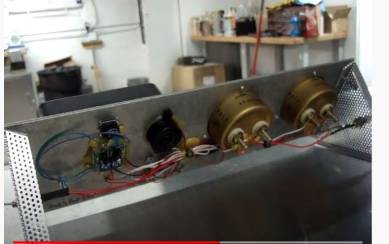

I have the real gauges, I am just not sure how to program them to move? I am assuming that activating lights and sound is fairly simple, I just have no idea on how to write the code to do it. I have found others online who have done all this in the past, but used older tech that again I have no idea on how to program or use. what would be needed to know the proper task definition?

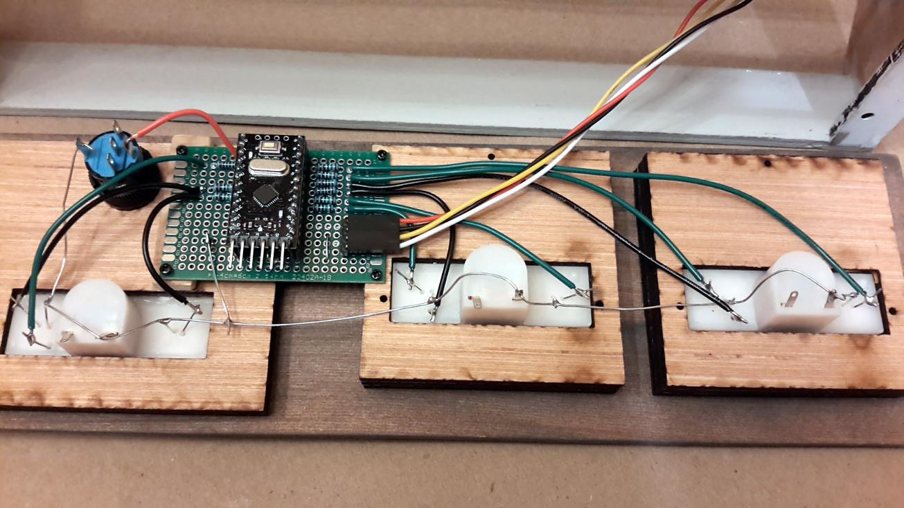

One picture shows a green circuit board with an Arduino mini pro with 3 connections to each meter and a cable going somewhere else. The 6 header pins on the Arduino are to program it through a cheap FTDI type programmer.
Did you acquire this all as a complete working system or who put it all together? If you bought it online, can you include a link to the product page?
To me, it looks like at least all the hardware is there. If someone has already gone that far, then I would also imagine some software is there as well.
What is at the other end of that cable which has 4 wires (black,red,yellow,white) ? Can you include a picture of what ever is there?
The 3 switches you mentioned in your first post. Are they already mounted on this panel?
Is some sort of sound unit (say SDCard player module with loud speaker ) also included with this kit ?

  1. I’ve just noticed that the there is an unconnected tab on the back of each meter. This would appear to be one of the coil connections (if those are really conventional analog meters). In that case, maybe only the panel meter backlights are active.

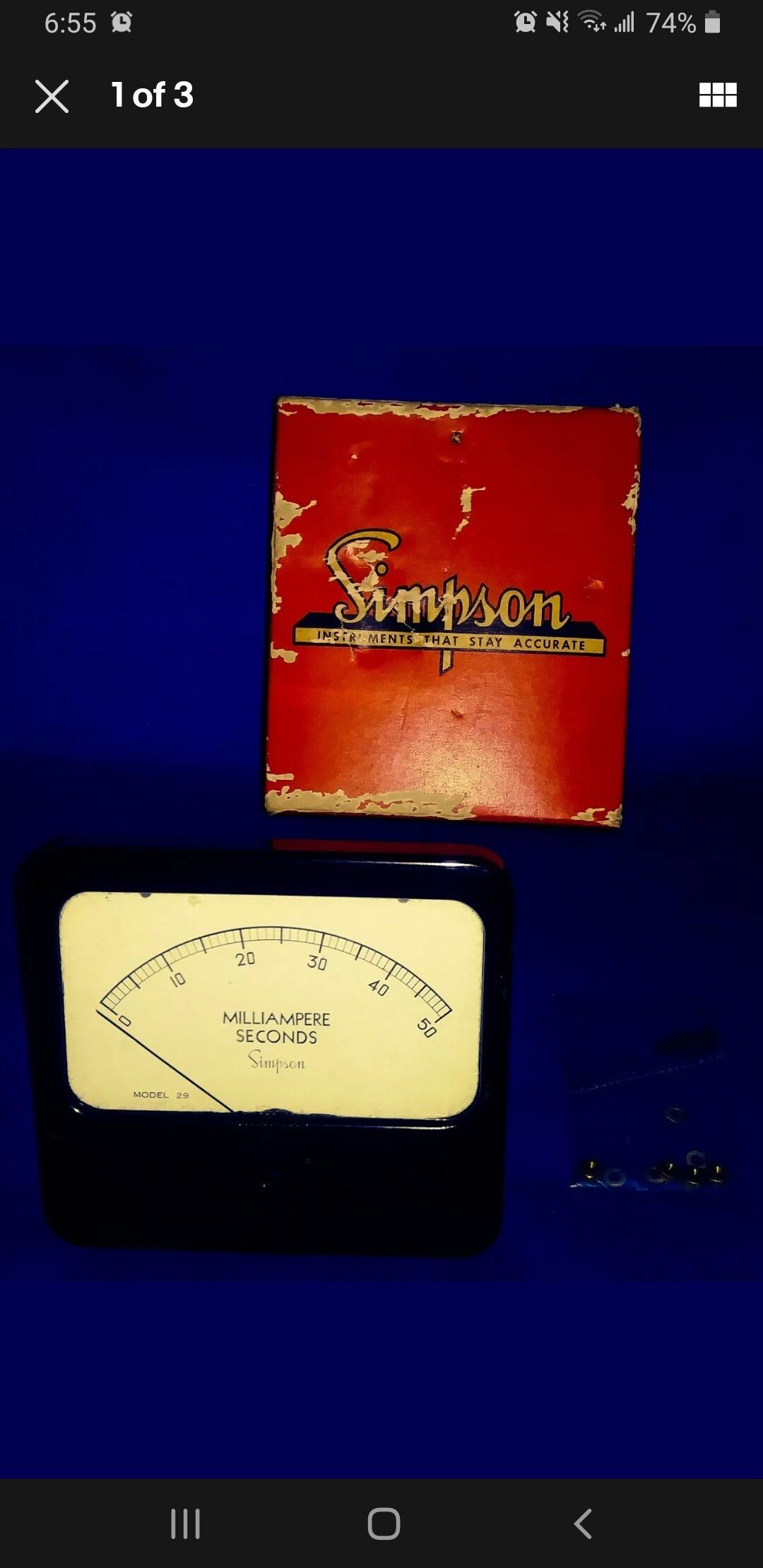

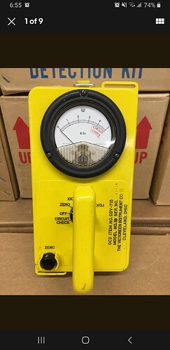

The pictures posted are just examples I found online of what others have done. I have two "VICTOREEN CDV-715 1A RADIATION DETECTOR 54510" meters and one "Simpson Model 29, 4.5" panel, 0-50 milliAmpere Seconds Meter".
OK. The pictures here (post #12) are clearly not related to those in post #7.
The round meter with the R/hr scale on the Geiger counter looks like it could be used easily.
The other one with the scale Milliampere second looks also like it could be used. I'm guessing that was intended to be used by some sort of energy measuring circuit (the scale implies it is a cumulative measurement) but the meter itself is probably a standard low milliamp type.
The above two appear to be moving coil type meters and the worst you'd have to do is remove an internal shunt or resistor network.
Panel meters with a non linear scale (moving iron types as found on say battery chargers) may be more difficult to use.
You could attempt to connect a 1.5volt battery with a 100K ohm series resistor to see if the meter needles kick over. Even if they fail that test, it does not mean they cannot be used, but such experiments could damage the meter if not done cautiously.
