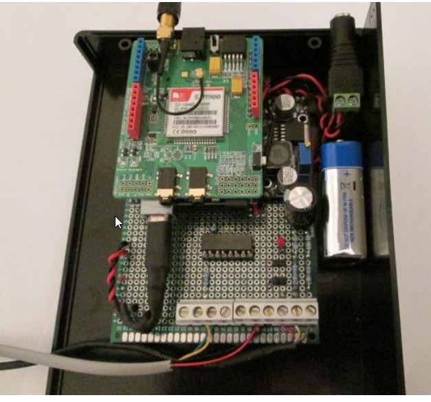

Though the buzzer may be only showing a low voltage, I would be against connecting anything directly to it as there is always a risk of mains voltage getting through to it.
I would think using a minature microphone and a variable resistor so you can sense the buzzers sound and then get a signal into the Ardunio.
To send an email or text requires a lot more hardware and program code, if you search the forum on Arduino Emails, Texts and SMS you will find lots of similar questions /answers/projects.
A pic below shows whats needed to send out a SMS to your phone, a Uno and SMS shield plus PSU etc; emails need a lot more.
