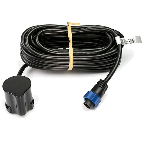

EDIT: A quick search and I found this sensor:

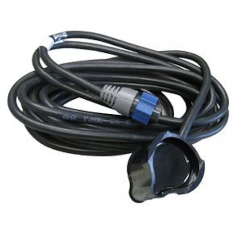

Ok. I found some more details on that sensor I mentioned earlier:
Says it is suitable for fiberglass hulls - not sure how that would translate to a carbon fibre hull.

Your only option is to try commercial sensors designed for that purpose and decide if they work well enough to be useful.
Measuring water depth through other materials It is a very difficult technical challenge, so expect to spend a significant amount of money for something that actually works. This is not an Arduino project.

  2. Your sensor will need to be different for different hull materials as some will absorb and not pass the sound from your sensor. So you will definitely need to have an assortment of sensors for your testing.
Look at the offerings from boat electronics companies. Sailors would love to avoid having a through hull to enable the depth meter, but a brief google shows me that the major players don't have such a thing.
I'll guess that it's too hard to configure such a thing for different hull thicknesses and materials. Maybe you can get one working as a one-off for your boat.
The big sail boat I owned had a depth sensor inside the hull in a water well.
It measured through the fibreglass hull.
