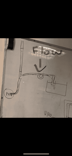

Hello guys! So i used a relay and everything is working great when there is water pumping, but i am facing an irritating problem, which is the water pump is sucking air when the main container is empty, therefore the flow sensor’s pin wheel keeps turning giving false readings and by false i mean not in a small range that i can predict and rule out by code, just random numbers, any ideas if it’s possible to keep the air out of the equation? Like if i put another tube and kept the other tube that has the flow sensor on immersed in water so the air finds its way out ? Just like burping the car radiator?
Something like this

Yes. I have a similar situation and intend to make the same solution. When the water gets to the vent point, the pump has done virtually all its job, and you just need to ensure gravity will do what the pump hasn't. When there is just air, there shouldn't be any going through the sensor - or hardly any..

Is the pump sucking water through the flow sensor, or pushing it through.
It sounds like you have a good flow sensor with low losses and even air being pumped will make it turn.
So how can you tell the difference fluid flow and gas flow?
Checking if flow media is there or not, is not the function of the flow meter. In your case you have flow media all the time, just its density changes.
