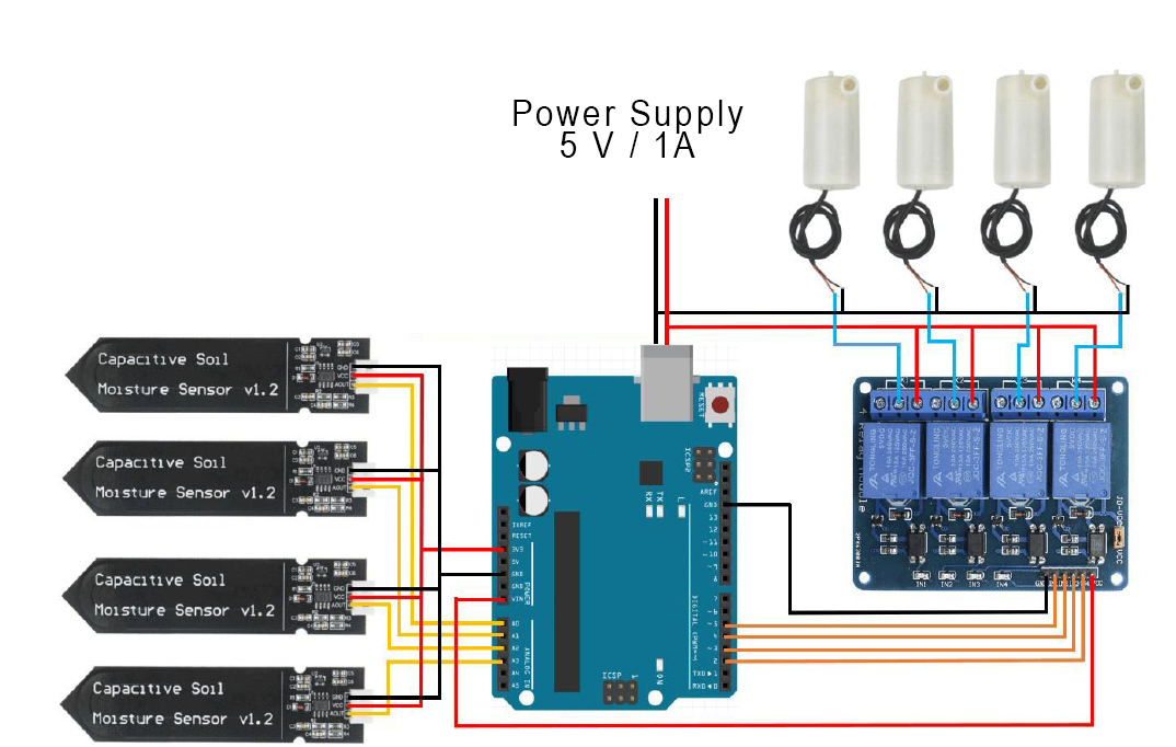

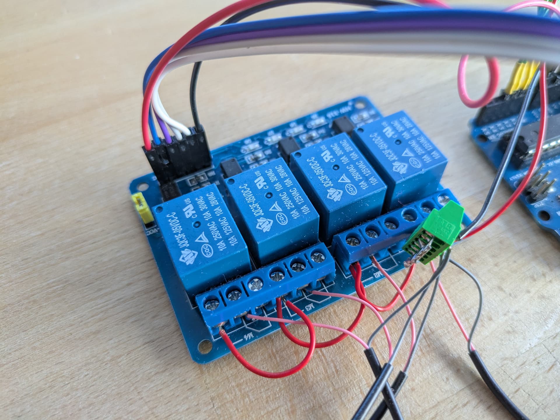

By the way, I had written a small class named AutomaticPump
to handle such a simple automatic pump which was making the sketch super easy to write.
Each pump has a name, a relay pin and a sensor pin (and optionally a threshold which defaults to 550). you build an array of such pumps and the only thing you need to do is begin all the pumps in the setup and update all the pumps in the loop.
something like this:

the output would be something like
Configuring the Green bean pump.
Configuring the strawberry pump.
Configuring the Old Tomato pump.
Configuring the Zucchini pump.
Green bean 1023 ON
strawberry 1023 ON
Old Tomato 456 OFF
Zucchini 398 OFF
Green bean 1023 ON
strawberry 1023 ON
Old Tomato 451 OFF
Zucchini 452 OFF
Green bean 1023 ON
strawberry 1023 ON
Old Tomato 454 OFF
Zucchini 451 OFF
