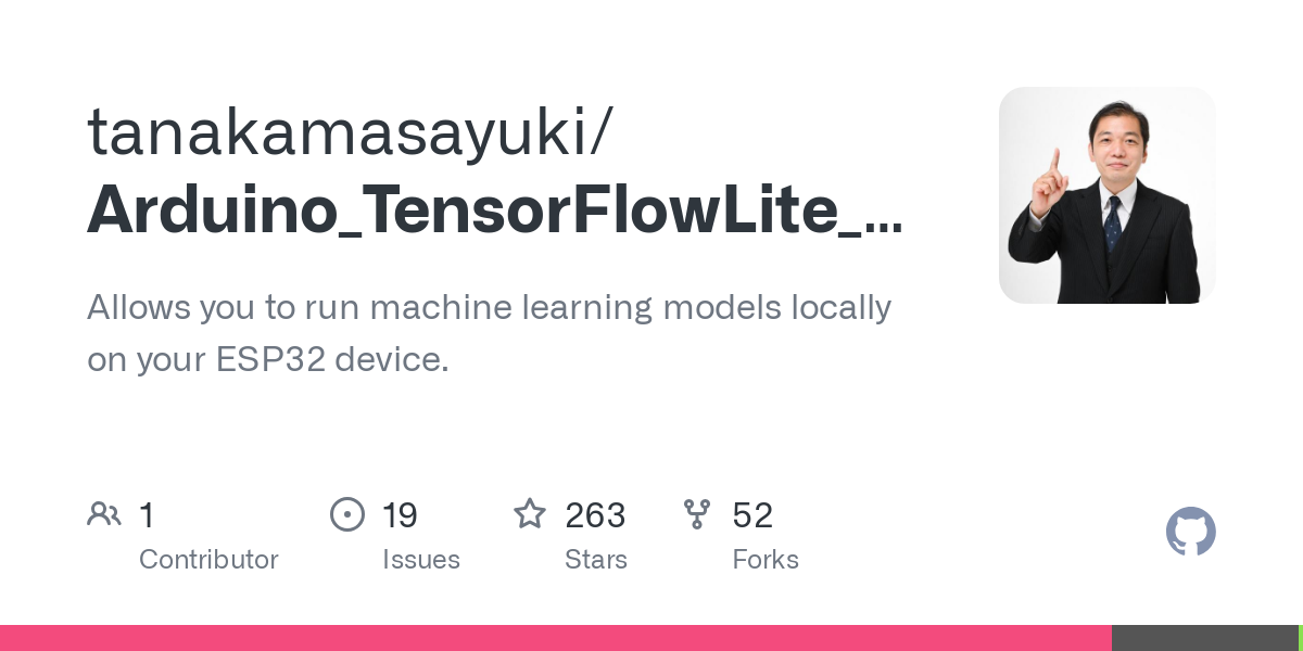

The files listed on github do not have file bfbs_namer.h
At this point I do not know how to go on.
It might be that the code that you are using is completely different from the Github link I posted.
You will have to provide the complete things you did.
Did you install it from the arduino-IDE library manager
did you install the library as a ZIP-library??
If yes from where did you download the TensorFlowLite_ESP32-library
post the exact link
I did a search for this filename and only came up with this
which seems not arduino related
Well, I have installed the library zip file from the below link:
