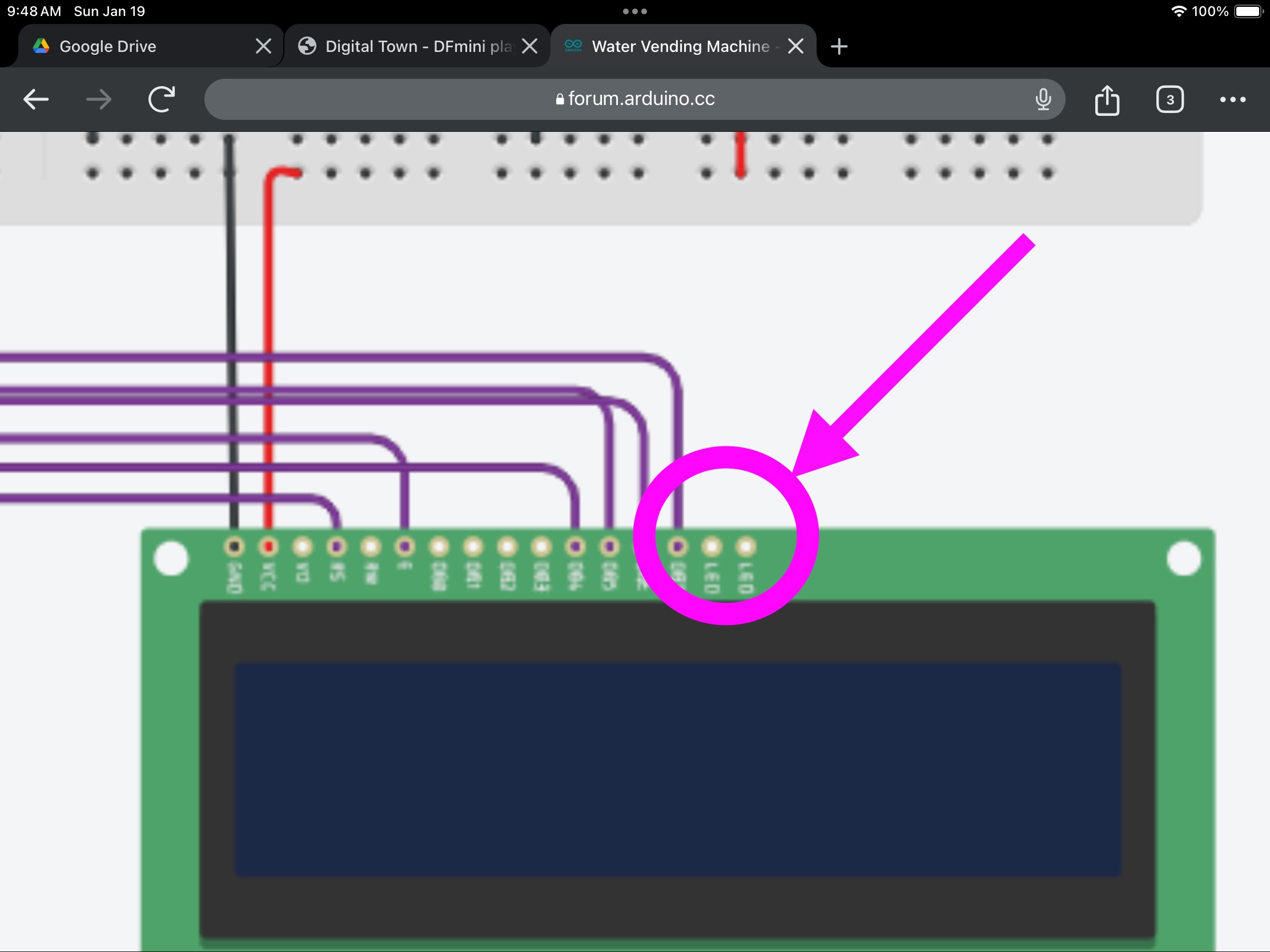

Hello I am planning on making a water vending Machine but instead of coins I will use plastic bottles (small, medium, larger) but the problem is :(I am using tinkerCad)
  • the LCD is not showing any texts
This is the circuit:
Here is the code:

Does it print
  // Display initial message in the serial monitor
  Serial.println("System Ready");
but show nothing on the LCD?
Remove from setup() anything that has nothing to do with the LCD, and stop the code executing at the end of setup(), a long delay will do
  delay(60000);
These steps are to isolate the LCD problem until you can fix it.
An alternate would be to use a sketch provided somewhere as a simple example of putting text on an LCD.
Working from simlpe code, or better yet a perfect and small example sketch you did not write or mess with is a good way to get each little part of your projext working , and gives you an opportunity to learn about those little parts.
Then using them and combining them will be its own challenge, but as least you'll know the separate parts all work.
a7
It doesn't print anything and also the LCD has no backlight is there something wrong with the connection?
Since you are using a simulation, we can expect that you have a wiring issue.
Does the simulation need a contrast potentialometer?
Have you examined closely an example for using the simulated LCD in the simulator you have chosen?
a7
Yes I already saw the example and it uses a potentiometer
does this print anything ?
#include <LiquidCrystal.h>  // Include standard LCD library
LiquidCrystal lcd(10, 11, 12, 3, 4, 13);  // Adjust pins according to your wiring
  lcd.begin(16, 2);
  lcd.clear();
  lcd.print("Water Vending");
void loop() {}
if not double check that 10, 11, 12, 3, 4, 13 are in the right order / at the right place. They should go respectively to rs, enable, d0, d1, d2, d3
I checked it and it is the right order but still no texts
if you rewire using the pins from the HelloWorld example
does it work?
I saw the problem already it needs a potentiometer. By the way, thank you and it works now
