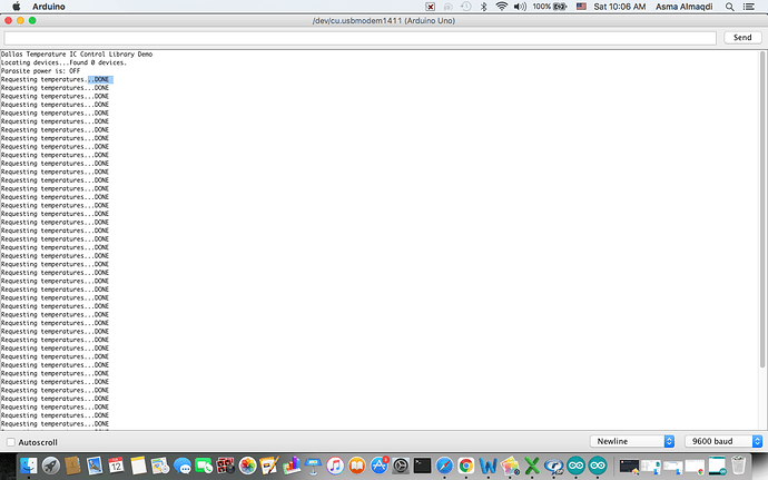

I am using Arduino UNO.
I installed oneWire and DallasTemperture libraries.
I get the error: No device found and it does not return the temp value.
I tried most of the files under DallasTemperture for example simple, single, alarm

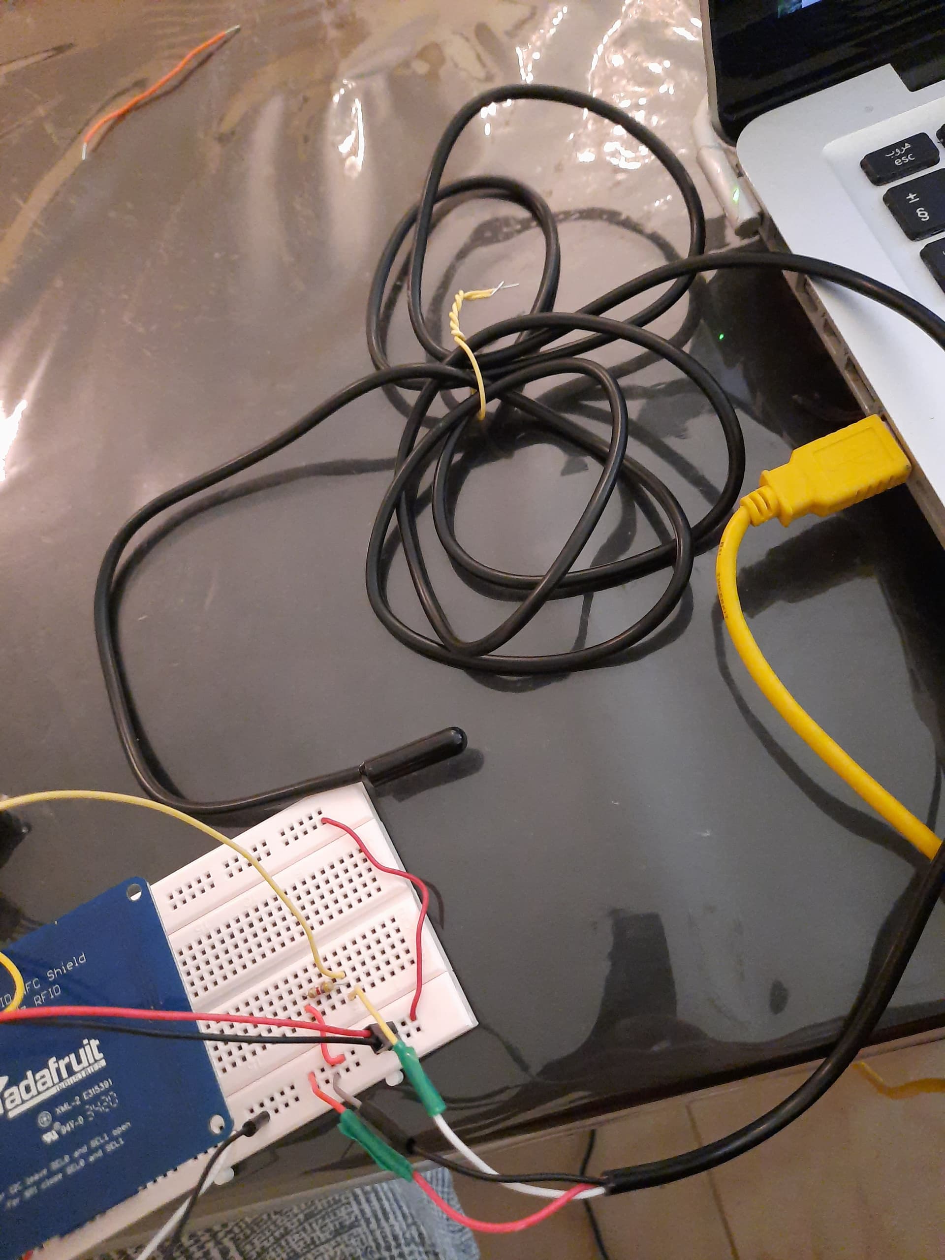

This is the circuit

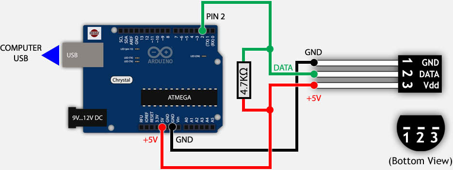

I am following exactly the circuit in this link: https://bildr.org/2011/07/ds18b20-arduino/

Check the wiring and the power supply for the sensor by using a DMM.
Not the best ever circuit diagram …
On some prototyping boards the power rails are not continuous across the width of the board - check that
Not relevant to the photo shown (such as it is :worried:), but one must always suspect the wiring. :roll_eyes:
What is that Adafruit board sneaking in to the photo anyway? :thinking:
No, that is a jumble of wires.

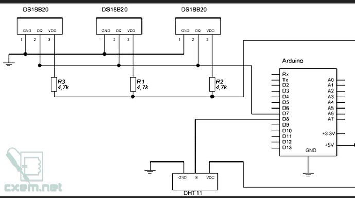

Good morning....
I am using both Arduino WIFI Sheild and adafruit RFID reader in my circuit. I want to display some sensors values and the users cards on the web.

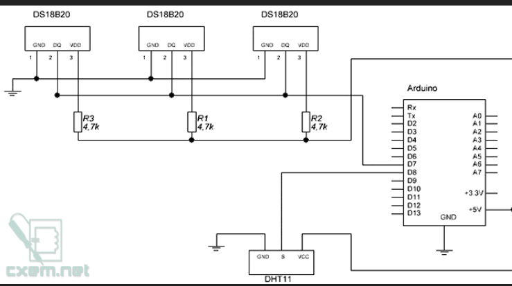

So just what are those 4k7 resistors doing? :astonished:
@hammy I agree with @Paul_B , that doesn't look right at all. The pull-ups are in the wrong place on all the ds18b20 and missing on the dht11 (although I suppose internal pull-up could be engaged there). Also, with one 4K7 per sensor, all those resistors in parallel will become a very strong pull-up and might stop the 1-wire bus working.

My mistake wasn’t clear on my schematic post . I was just showing an example of what a schematic “is “ for the OP.It’s wasnt intended to be a real circuit ( I just grabbed it from the internet ) to show how to draw stuff .
Apologies for misleading people !
