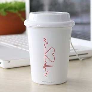

My project is a small propagation Greenhouse made of an IKEA box.
The water sensors are in 2 or 3 locations.
  1. Main Water Bucket
  2. Humidity Steam Cup - It produces humidity, its a car humidifier made of a small cup.
    As seen here:
    http://i00.i.aliimg.com/wsphoto/v0/32244199124/Car-mini-font-b-usb-b-font-humidifier-font-b-cup-b-font-computer-humidifier-air.jpg
  3. havent decided on this one yet but if it works, a Water Heater. To provide heat.
If the water runs out in humidifier (or the water heater) I provide water using a pump and the Main Water Bucket.
Sounds good. Float switches will work just fine for that.
