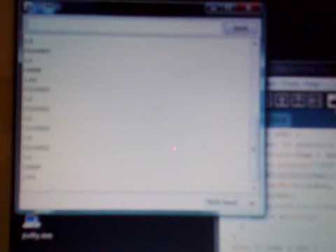

Wave Shield Door Alarm / Welcome Music
When I enter my apartment I am welcomed home by a song playing on speakers. The door opening triggers an IR sensor which activates a Wave Shield. Only one song will play each time, and it plays a different song every time. After all the songs on the SD card have eventually been played it loops back to the beginning. You could potentially store up to 2 hours of songs on the card.
The contribution I wanted to make here is the Code. There is an If Statement that is activated when the sensor is activated. The original code would play every song in a row without stopping.
IR Sensor [ch8594] Arduino Wave Shield [ch8594] Speakers

I don't have a video demonstration, but this fellow used a different type of door sensor to make an arduino door alarm.
This code uses the Af Wave library.
Here is a website for all things Wave Shield:
http://www.ladyada.net/make/waveshield/index.html
One other thing that has been added is a relay to turn the speakers off when they are not being used. The speakers are plugged into a 'PowerSwitchTail' which is plugged into the wall. It is a short extension cord that can be turned on and off with a 5v input, so I treat it like an LED and turn it on when the music starts playing on the Wave Shield.
http://powerswitchtail.com/default.aspx
