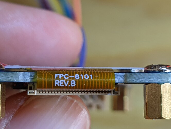

@viktak, Hi, welcome to the forum!
I suggest you try with this line (if it is a recent Waveshare version):
//#define GxEPD2_DRIVER_CLASS GxEPD2_150_BN  // DEPG0150BN 200x200, SSD1681, (FPC8101), TTGO T5 V2.4.1
else report the inking found on the flex connector.

Thank you for your quick and precise reply! I just implemented both changes you sugested and it worked immediately. Thank you!

For the sake of others who might end up here later in the same shoes, hereis the flex connector:
