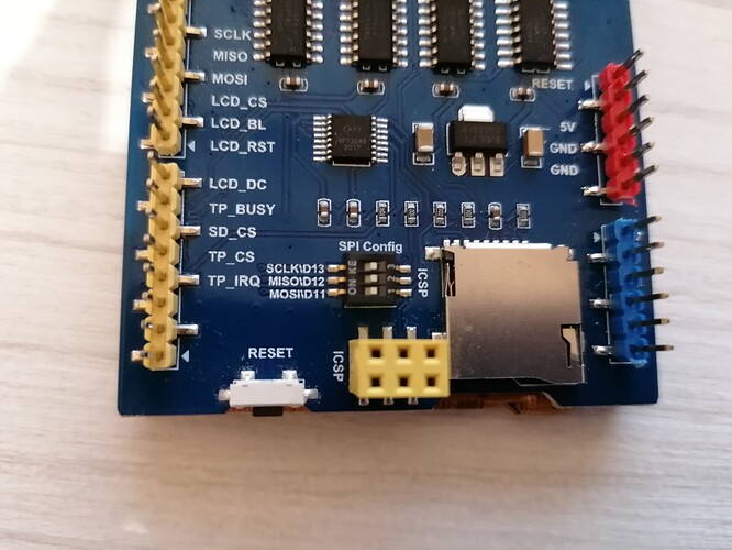

I have a Waveshare ILI9486 TFT 3.5 INCH LCD DISPLAY and I want to get it working with the example from the code attached below to work on the following hardware:
I have a MKR WIFI 1010 and I put in on a MKR2UNO adapter.
I am using a MKR WIFI 1010 because I want to create an application where I can connect through IP to do some things that are not related to this topic.
The main thing I want to do right now is to make the display work on this MKR WIFI 1010 put on this MKR2UNO adapter using the examples attached in the link below. I did some wiring because apparently the shield will not go in because of MKR WIFI 1010's not letting it go in fully and I just connected the shield using wires. ( schematic below )
When I upload the sketch from Arduino to MKR WIFI 1010, the screen goes on, but being white, and after that it goes off.. not showing nothing... Is weird because on Arduino Uno is working perfectly fine. I also went on DEV_config.h and define my pins how I connected them on MKR2UNO adapter, but unfortunately I experienced the same thing; after uploading the sketch screen goes black, showing nothing.

I just tried to "read" the schematics of the MKR2UNO, but I am confused. The usual UNO SPI pins are not where I expect them to be. https://content.arduino.cc/assets/MKR2UNO_V3.0_sch.pdf
Maybe you need to use the ICSP pins for SPI, and close the switches on the display for ICSP.
But then there would be a conflict on pins D8 and D9.
Unlike the Arduino UNO, the MKR2UNO Adapter do NOT have I2C signals on A4 and A5 and SPI on pins 11, 12 and 13.
This is strange...
So, you say that I need to put the SCLK, MOSI and MISO pins from the display on the ICSP pins on MKR2UNO on where they belong in the schematics?
How exactly can I do this? Sorry for being noob, but I am still learning...
There are three jumper switches on the display for this, I think normally open.
Go have a look at the schematics of the display, Waveshare wiki documents well.
But it would not help, because:
I think you should wire your display directly to your processor, without the MKR2UNO.
If you get this working, then you could wire a proto-board for a final and stable solution.
Oh, so I need to try it directly on the MKR WIFI 1010 then...
That is unfortunate... but I will give it a try and I will keep you updated.
Thank you for your patience and tips!
No, I have not studied your MKR2UNO pinout.
But I would just guess that MOSI, SCK will be found on the 3x2 SPI header.
Make sure that the SPI_Config jumpers are open.
And you can use any GPIO pins for LCD_CS, LCD_DC, LCD_RST, LCD_BL. But obviously easier if you select the same ones as on the display.

Hi @david_prentice
Thank you for your advice
Those jumpers are meant to be on the left where there are SCLK, MISO and MOSI.. as you say?
The switches should be in the ICSP position.
You should connect MOSI and SCK from the 3x2 ICSP header.
In an ideal world you would switch to ICSP position and plug display straight into the MKR2UNO . However the MKR WIFI 1010 will be in the way. You need "tall" sockets on the MKR2UNO.
Personally, I would just try "stacking headers" if you have some.. Or just use individual jumper cables i.e. for 3.3V, 5V, GND, D9-D7 and ICSP pins 3,4.
8 cables is not too daunting.

Now my display is working just fine with MKR 1010 WIFI on the MKR2UNO adapter.
I just took the Waveshare library and modified the .cpp file in the src of the library and just put wires on the pins 5, 4, 3 and 2 for LCD_CS, LCD_BL, LCD_RST and LCD_DC, connected the 3.3V, 5V, GND, and ICSP header as well.
Looks like everything is working well.
