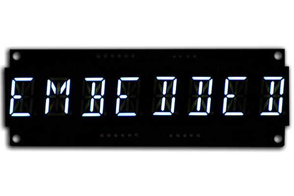

I am also looking at those same Adafruit mini 8x8 matrix modules, thinking that I could use two to display four digits in a 8x16 matrix using a 4x6 or 4x8 font. In my case, I would have liked to use normal alphanumeric LEDs but they won't fit inside the neopixel ring that I would like to use for analog readout.
Would an alphanumeric LED work in your case, maybe one of these?
