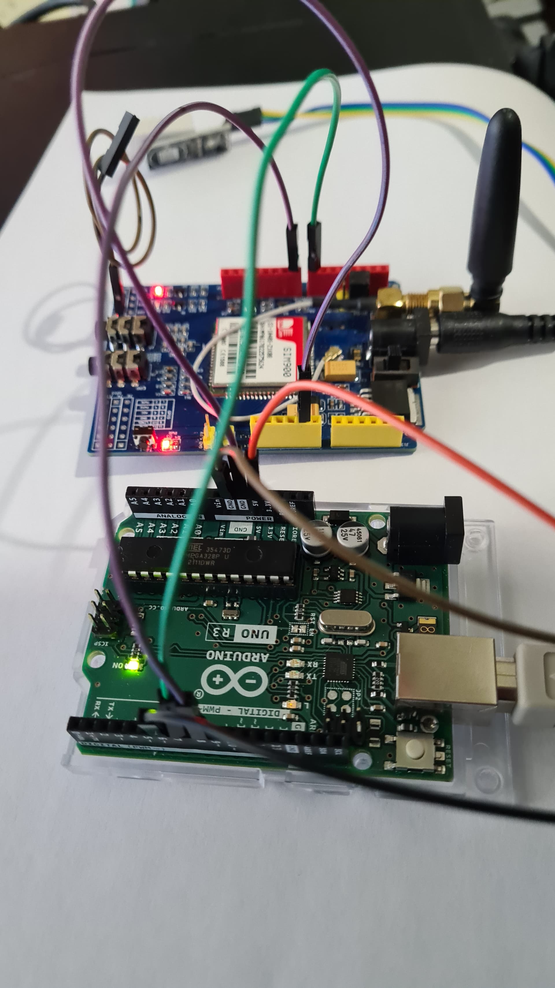

My problem is the connection between the SIM900 card, the UNO card and the DHT22 probe. I can't figure out where to connect them.

Maybe something is getting lost in translation. Does UNO card = Arduino UNO board and SIM900 card = SIM900 shield?
The 2 should just plug together.
You need to find a schematic for the SIM900 shield so you can work out which pins are not being used by the SIM900. You should then be able to connect the DHT22 to one of the unused pins.

My problem I don't know where to connect my DHT22 sensor to my UNO card.

Idahowalker I followed your links the connection is made and the DHT22 probe works on the UNO.
I can't get the SIM900 to work on the UNO.

I tried without the SIM900 and it works on the UNO alone.
With the card I can't get it to work (mySerial(7, 8) and pin 6 on the UNO
Laure
You understand I cannot see your code, right?
You understand I cannot see your wiring, right?
You understand you can post your code in code tags so others can see your code?
You understand you can post images of your project so others can see try to see the wiring, right?

If sensorPin was changed from A0 to a 6 then
DHT dht(sensorPin, DHTTYPE);
would be changed to use sensor pin 6.
