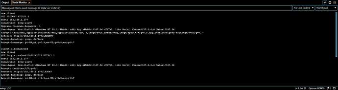

Despite all that, if you do a Force Reload -- usually by holding Shift while clicking on Refresh in the toolbar or in addition to the key sequence -- does that serve the file again and fix it?
You might also check the Network monitor and verify if the request is going to cache, what is being seen as the response, etc
I had similar issue, turned out that i had preloaded page layout and forgot to refresh after every change
I did some tests with Reload, but I was also unsuccessful.

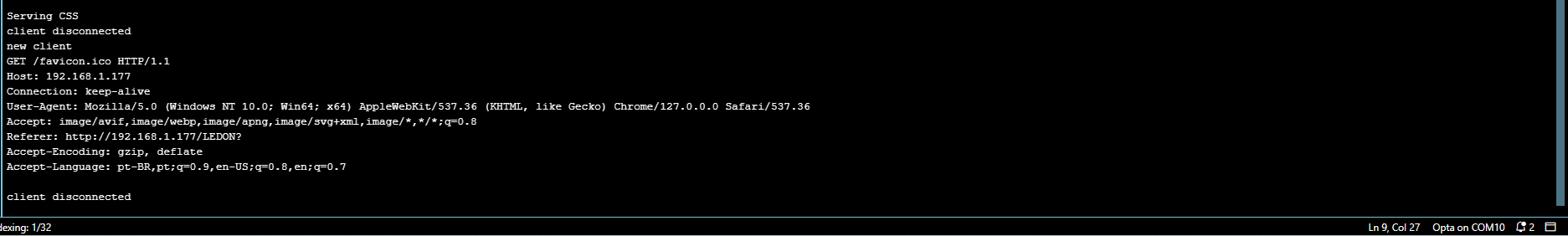

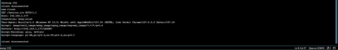

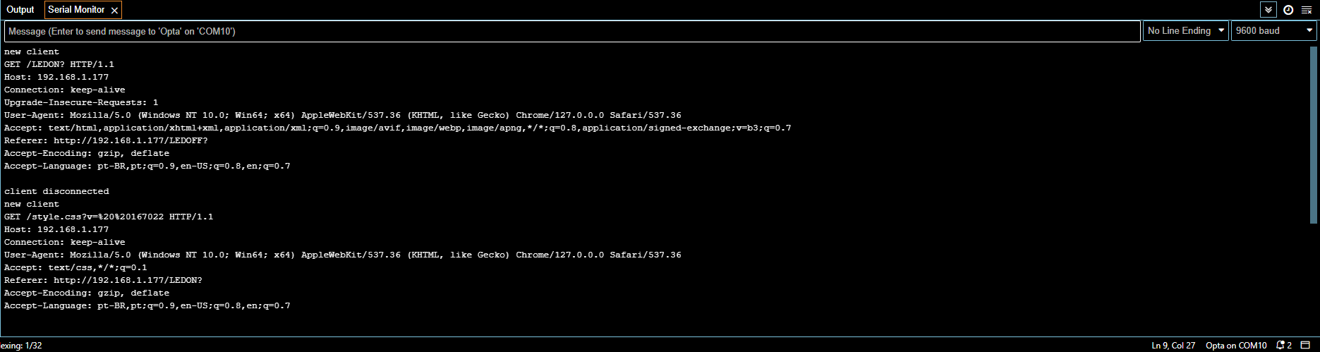

I checked my serial monitor and it seems that it is sending the CSS to the Cache normally.
I also verified that the updated code in the programming CSS is appearing in the Web Page inspection as shown in the images below, but the code that is there is not updated on the Web Page, even though it is there, it does not update the interface.
I'm really trying to understand this problem but I can't find a solution. I did a test containing the HTML, CSS and C++ files together in a single file and whenever I update the CSS my page also updates with the new changes in the interface, but the code is very difficult to read, understand, it's very dirty.
That last screenshot of the Network monitor shows the problem. For the style.css request, the response is both HTML content, and then the HTTP headers and content for the CSS. (All those headers being sent were not even being seen as headers, just invalid CSS.) This is because of the structure of the code in the loop, which calls both generateHTML before and sendCSS after the condition
is evaluated as true. The code needs to be restructured so that only one response (with headers and content) is sent each time through the loop, between the client = server.available() and the client.stop()
BTW, the indexOf check is too lenient. It should really be more like
if (currentLine.startsWith("GET /style.css")) {
Do you understand why?
