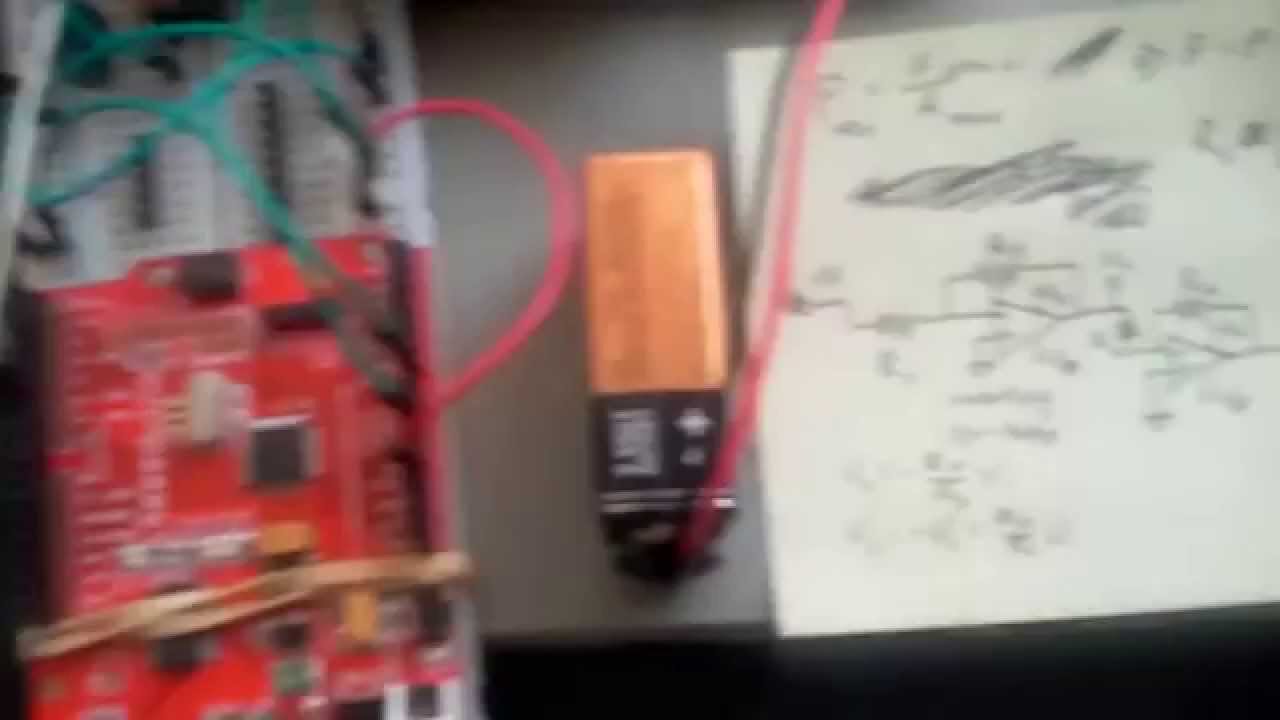

I see this guy have made something similar to what you are talking about. Guess I need some FSRs that can handle more weight.

As the impact is short and an FSR is basically a resistor, you probably have to buffer the signal with an OpAmp, similar to what they did in that video (though I don't see why you should go through the trouble of getting a dual power supply).
