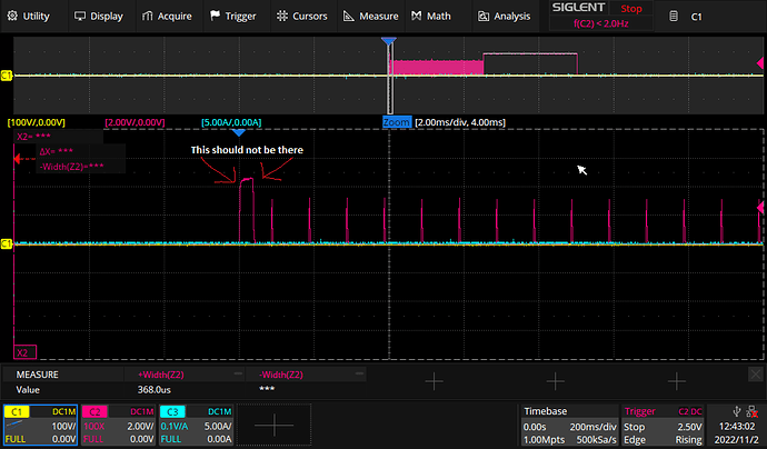

I recently found a weird behaviour of my arduino uno.
I'm switching a 1kHz PWM signal on pin 3, everything workes.
Then the duty cycle reaches 250 = 100%, after that the duty cycle is switched off = 0;
After a 1sec delay, the pwm signal is switched on again, the very first pwm impulse is incorrect.
The duty cycle is too long, and the timing is wrong.
Oscilloscope screenshots attached:
Since I set up a huge project with several hundrets lines of code, I summarized a working code that produces the very same output.

OCR2A has nothing to do with prescaler. It is compare value of Timer2 channel A. It will be changed any time when you use analogWrite() on Timer2 A channel

				OCR2A = val; // set pwm duty
			#endif
It's awkward to interpret your code with the mix of binary and arduino defaults. I'm guessing you're going for WGM Mode 3 with PWM on Pin3/OCR2B?
If you are bit-twiddling the WGM2 bit in TCCR2B, I'd go ahead and set the rest of the registers like TCCR2A and TCNT2, and instead of using analogWrite(...) I'd use OCR2B.
I didn't dig into it, but I'd suspect that the digitalWrite() from analogWrite(PWM_PIN,LOW) twiddles some of the registers, and lets TCNT2 count above OCR2A, giving you a one-shot behavior when you re-enable PWM.
Thanks DaveX,
that was indeed the case.
I'm now using OCR2B instead of analogWrite.
Had to rewrite some of my code, but the one shot behaviour is now gone.
I needed to get away from analogWrite() and learn how to properly use the registers.
Kind regards!
