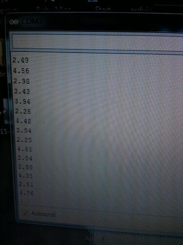

Hi, I'm using this arduino code:

And this circuit layout:
When using this I am getting a lot of weird voltage spikes as shown below. As far as I can tell this shouldn't be happening while the switch is closed and I'm starting to wonder if I have a defective arduino somehow. Help is much appreciated.
Well, the IDE reference states:
"If the analog input pin is not connected to anything, the value returned by analogRead() will fluctuate based on a number of factors (e.g. the values of the other analog inputs, how close your hand is to the board, etc.). "
So that should be your first area of inquiry.
Why are you doing an analogRead of a switch in the first place? Is it going to be half-on?
Thank you, I think this is what I need to do. Too bad I don't have any 10k resistors...
EDIT:
I'm really proud of myself for thinking of this, I used my body as a pull down resistor and it worked perfectly!
The Arduino inputs have internal pull up resistors that you can enable.
aarg:
As mentioned in my thread. Wire between the input and Gnd. Enable the pull-up. Use a digitalRead. Then it should work fine.
