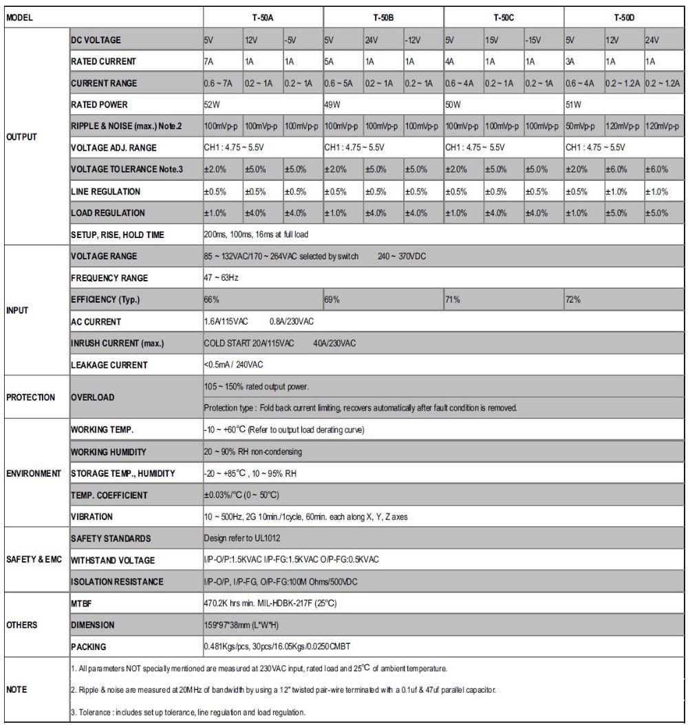

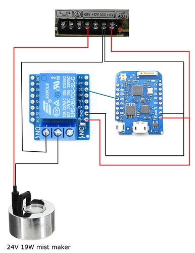

I have a power supply with three output voltages:
There is only one common (com) ground to be used.
I wonder whether it is OK to wire relay like this:
Thanks in advance for any suggestions.

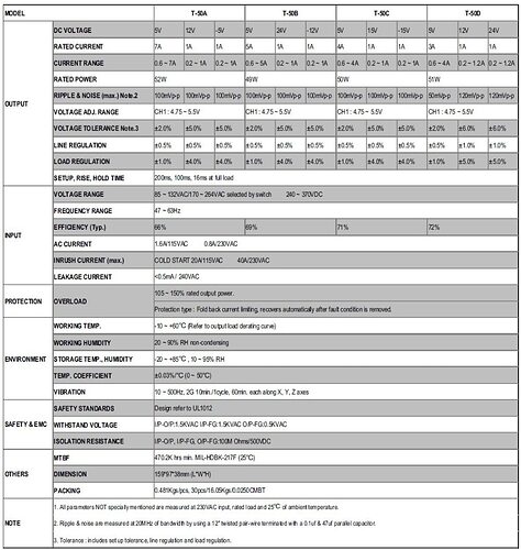

There are power supply specs (if needed):
Please let me know if any additional info is needed.
