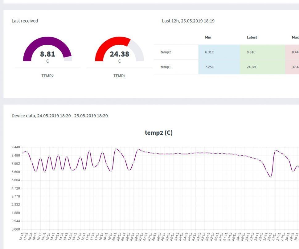

So I finally managed to solve it!
I had to specify D1 as pin. Just using a number as 1 (as taken from the sketch example) did not work.

It was properly wired. But...
if(tempC != DEVICE_DISCONNECTED_C)
Could not find any device. Device could be found on D1 not on 1.
The error message is not generated by the library but from the code example, so in that sense it was not very helpful to identify the problem. It was still a software issue

On the WeMOS D1 is GPIO5, so most likely D1 is defined as 5. There is no obvious relation between the WeMOS (or NodeMCU) D0-D9 pin numbering and the ESP8266 GPIO pin numbers...
