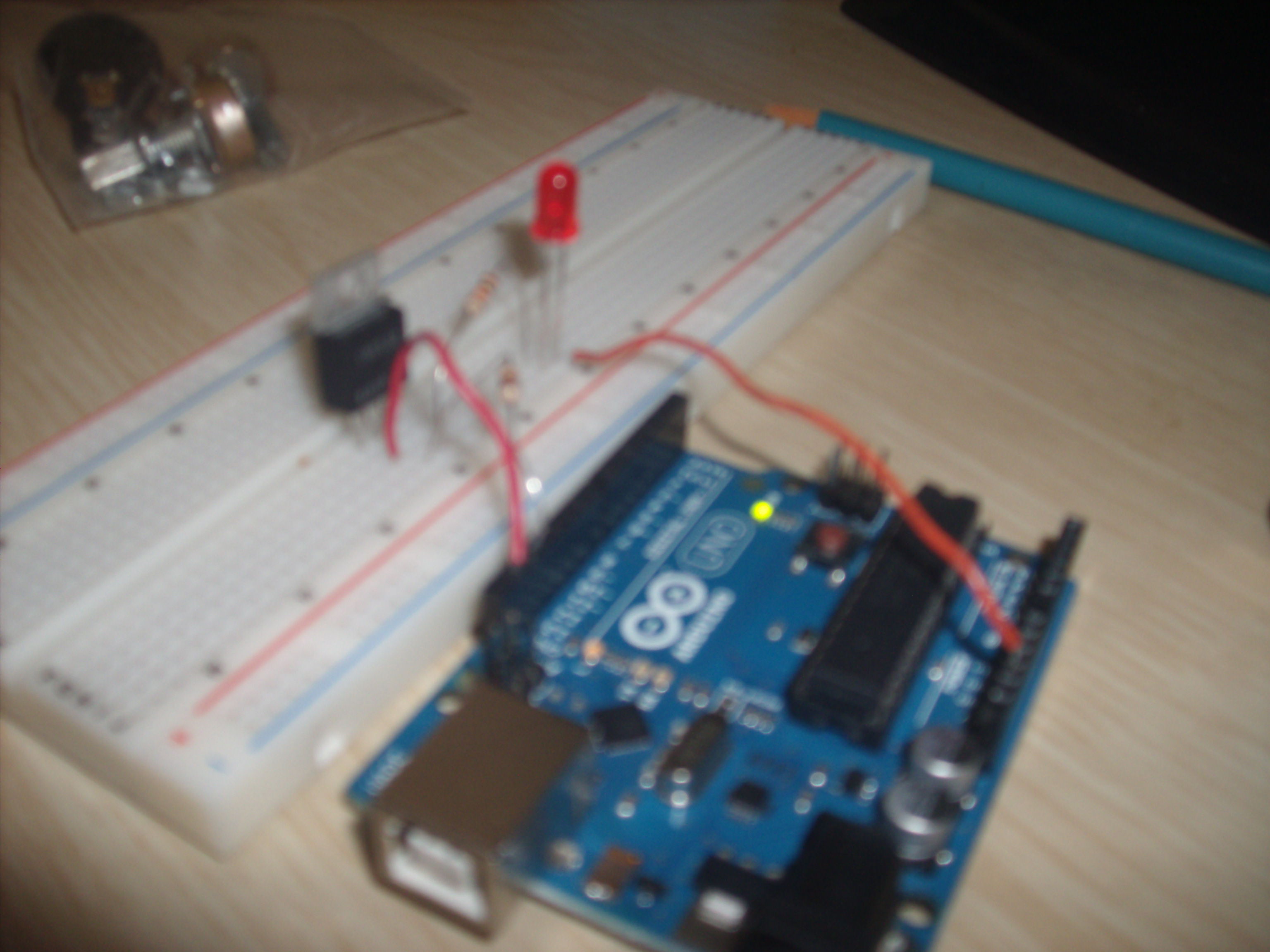

Then you have either wired it up wrong, got the LED round the wrong way or you have a faulty transistor. Did you replace it because your previous circuit would have distroyed your previous one.

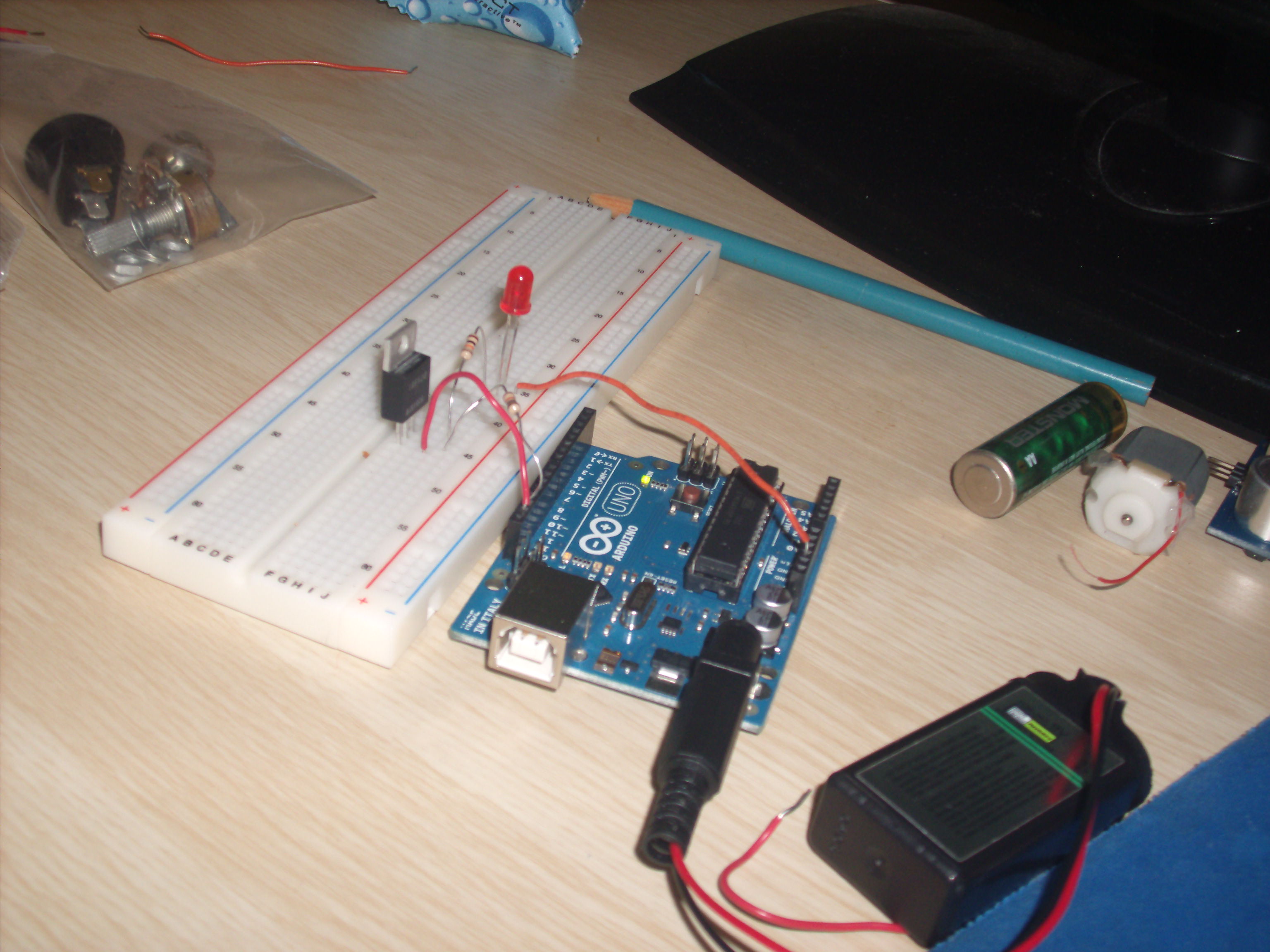

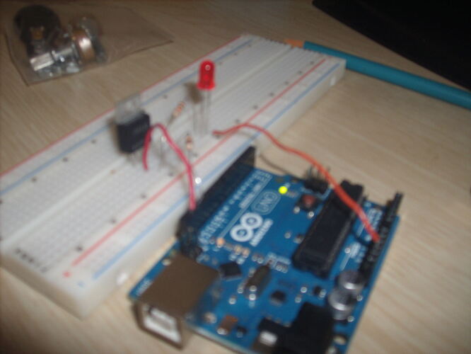

I only see two wires connecting your circuit to the arduino, there should be three. A 5v, a ground and a signal from pin 13.
guesse what, my red led is dead.
and i felt really the transistor really hot after touching it
The transistor should not be hot check you have identified the leads correctly. Also have you sorted out the missing wire from those photos?
can you put photo of it, its gonna be easy for me to plug the wires
@Muneed
I look at your picture, and I want to know what type of transistor you are using - NPN ? PNP ? MOSFET ? What ? Well you can tell by the number/letter in front of the transistor. The one you are using is a TO-220 <-- Package type. That tell me it is a "power type" I can handle a few amps.. And yes IT WILL get HOT !! if a lot of currents go through it. ( need a heatsink ) Here the site I use when I have a number/letter of a unknow transistor. http://www.datasheetcatalog.com/

IRF520 Mosfet Transistor
Now you tell me!!!!!
That is a FET it is not a transistor. All that stuff about how a transistor works is not relevant to your device. What is more your device requires 10V to turn it on. This is more than the arduino can supply so in general you can't use this device with the arrangement you have been looking for.
So how did you identify the emitter base and collector on you device because it doesn't have them. It has a gate drain and source. So basically you have been lying when you say you have.
I was having a feeling that was a MOSFET. That will explain the transistor got hot. Kiss goodbye the LED. I hope the Arduino is still working. Why you simply use a 2N3904 or something like that ? No parts, right ?
