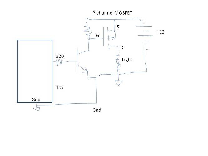

I want to control things with transistors instead of relays.
Is this an accurate example of a basic transistor setup to control a 5A-12V device?
No ![]()
Do you want to use a normal transistor, a darlington transistor or a mosfet ?
Do you have one ? which type ?
In the picture is a mosfet, but if that is a n-channel mosfet, the source should be connected to ground.
For protection you can add a resistor of 100 ohm (100 ohm to 10k) from pin 4 to the gate.
You could also add a fly-back diode over the load.
I have a ton of IRF9540N P-channel mosfets at my disposal.
My diagram shows the transistor from the back side because I drew it before I labeled the outputs. I know the difference in the pinouts so that won't be a mistake as long as the question is to the label of the pinouts and not the actual placement.
If that device is a p-channel FET then no it will not work.
You have to get the gate up to 12V to turn it off and it is connected to an arduino pin which will only get up to 5V.
Yet again by not supplying all relevant information you have wasted the time of all those who have answered this thread so far.
Ah - P-channel.
In that case you need an NPN in front of it, the Arduino can't supply 12V to the Gate to turn the P-channel off:

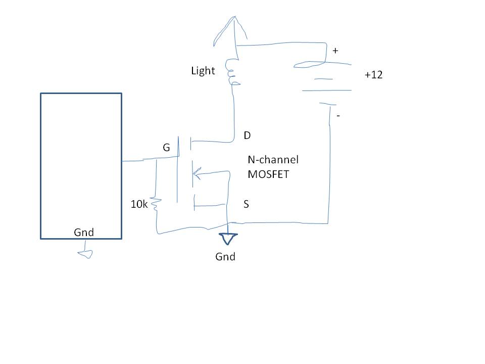

If you are going to buy new parts, buy a 'logic level' n-channel mosfet. That is the most simple way.
All the extra components you need are a protection resistor from Arduino to gate, perhaps a fly-back diode over the load, and maybe 100k resistor from gate to ground for a pre-defined state during startup.
https://www.sparkfun.com/products/10213
Thanks for a good, easily understandable, reply.
A logic level mosfet sounds good.
