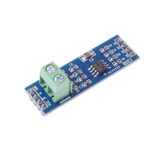

What cable can I use for communication using TTL to RS485 Module?
I'm using the TTL to RS485 Module as shown below. I want to connect 2 slaves to the master with a distance of 5-7 meters and use the RTU modbus library. I'm still confused about the cable that can be used. Can I use a cable like the picture below? Please give me suggestion and information about this?
Thanks
RS485 MODULE

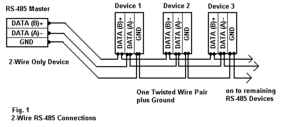

basically 2 (1 twisted pair)
This should help;

Sorry, maybe this is a very basic question. But I'm still confused, in the picture above, there are 4 wires namely red, green, white and black and there is also a ground. I'm still confused about connecting anywhere because there are only 2 pins, namely A B to connect the slave, while in the picture above there is ground. Can you explain it to me?
And for ground connected to which ground?

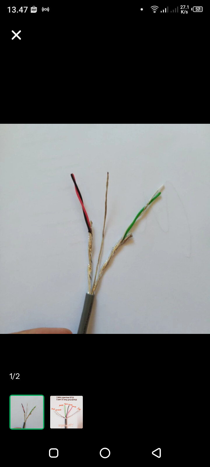

Ok...if I buy the cable like the picture I posted above and I twist the white-green and black-red like the picture below. Then, white-green to pin A and black-red to pin B. Can it be like that? sorry if im wrong.
And for the ground connected to which ground? ground module rs485 or ground microcontroller?
The cable you have shown has four twisted pairs, I think, you only need one.
BLACK and RED will do.
Put A on the RED wire and B on the Black wire, you do not have to twist anything, RED and BLACK are already twisted together.
Leave the other three pairs ( four wires ) alone.
