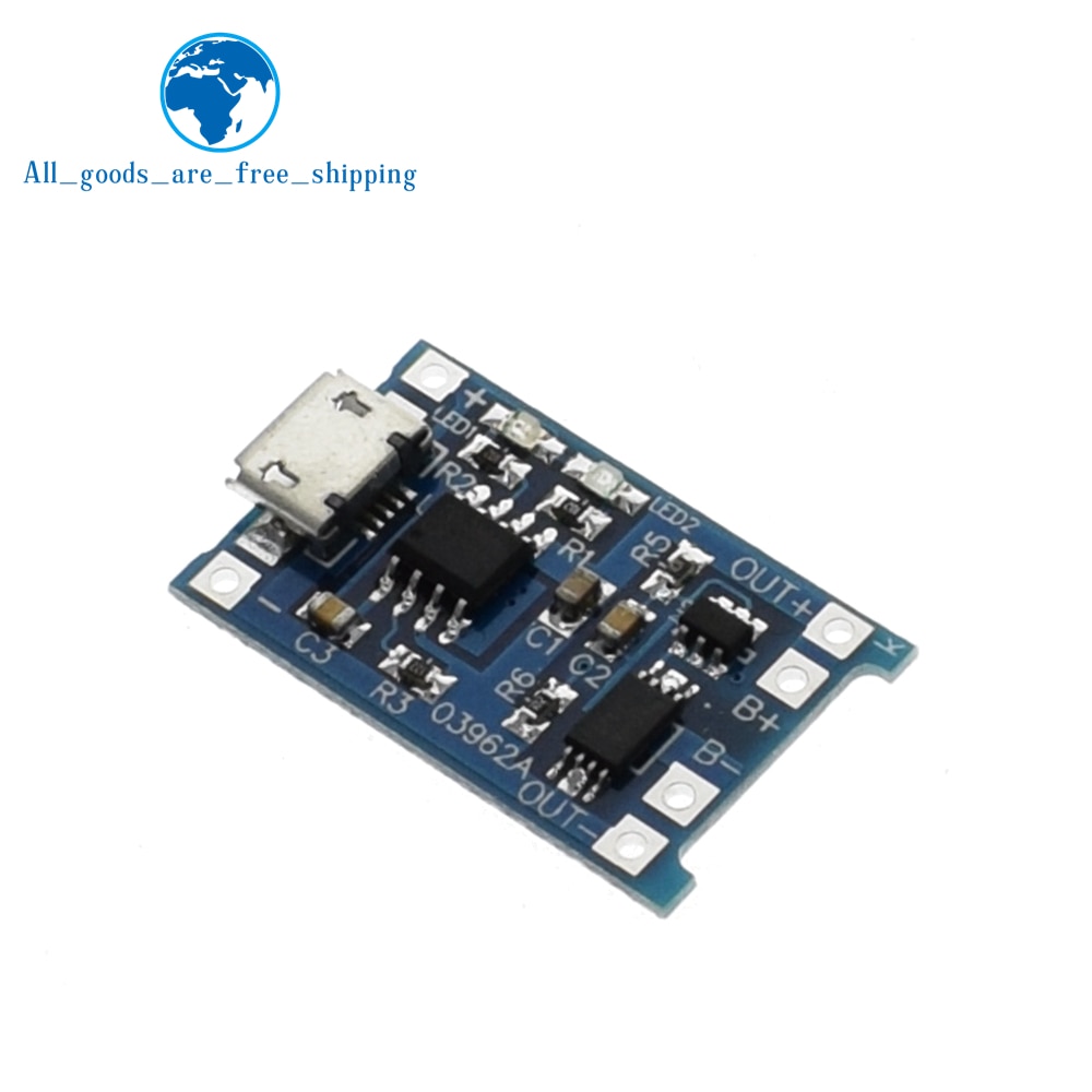

Hi all. I'm in the final part of my project where i will be monitoring the water level of a tank and send data over rf back home. This tank is to far away from mains power zo i'll be powering the arduino with a little solar panel.
Now my question is wich of these two charging modules would be the best for charging a single Lithium 18650 battery?
First one i have is this one:
5pcs 5V Step-Up Power Module Lithium Battery Charging Protection Board Boost Converter LED Display USB For DIY Charger 134N3P
The second o have is this one:
5 pcs Micro USB 5V 1A 18650 TP4056 Lithium Battery Charger Module Charging Board With Protection Dual Functions 1A Li-ion
For powering the arduino i'll use a separate module. I tried the first module to charge the batterij en power the arduino at the same time but it has a cut of function to avoid draining your battery if the power consumption is below a certain level and the arduino usage is below that.
Second question is, should i put a diode between the solar panel and the charge controller to avoid "frying" the solar panel? Not even sure f that is possible.

In the end i used this module for charging the 18650.
https://m.aliexpress.com/item/32934427176.html?spm=a2g0n.orderlist-amp.item.32934427176&aff_trace_key=&aff_platform=msite&m_page_id=2040amp-GLYckj1gxRLwAWO63aCoXg1563740590071
Then i used thecsecond board to protect the battery from overdischarging
https://m.aliexpress.com/item/32631718585.html?trace=wwwdetail2mobilesitedetail&productId=32631718585&productSubject=New-5Pcs-lot-5V-1A-Micro-USB-18650-Lithium-Battery-Charging-Board-Charger-Module-Protection-Dual

No the first one only charges the battery. If you put your load on there now and there would not be enough charge from your panel you can deplete the battery past its lowest alowable voltage. This will damafe your battery and is even dangerous since it can catch on fire.
The second board is connected to the battery and via that board I power my projects. That board has a low voltage cutoff sp it will stop providing power to my project and not damage my battery and my property.

Okay, how you kept your charging module from frying when the VIN is possible to exceed its limits, due to open circuit voltage of the solar panel? ( assuming "no load scenario" when the battery is fully charged ). Let say it accepts 4-6 V to the input, you put 5V panel, but the open circuit voltage rise to more than 6V, hence destroying the board?
Not sure what board you think cpukd be fried. The chargecontroler i used?
Specs are: Solar panel input: 4.4-6V
Solarpanel i used was a "6v" panel. Running since installed, still running. In two diffrent setups.

Still not reading datasheets ?
TP4056 DATASHEET
What does it say page-1 under "ABSOLUTE MAXIMUM RATINGS" ?
·Input Supply Voltage(VCC):-0.3V~8V
Maybe , instead of wasting everyone else's time, you should read a datasheet for once.
It clearly says the maximum input voltage is 8V
(8V>6V)

The only "problem" in your other post (T4056) was you didn't read page 2 of the datasheet where it says the typical temperature was 145 degrees C (so there was no heating problem)
The only "problem" in this post is you didn't read page 1 of the same datasheet where it says
the maximum input voltage is 8V (2V HIGHER than the maximum OUTPUT voltage of the solar panel,
so again, there was no problem and thus no solution was required.
We don't mind providing assistance but we can't hold the datasheet in front of your face. You have to
make a little effort.
The datasheet shows that the IC can tolerate 8V, which is 2V higher than the solar panel maximum output voltage so there is no reason for concern. If you read the datasheet you would know that.

You need to remember that as the load on the solar cell decreases, that is the battery approaches full charge, the voltage from the solar cell will increase.
You need to check what the open circuit voltage of the solar cells is in sunlight.
6V rating will be a loaded voltage on the cell.
