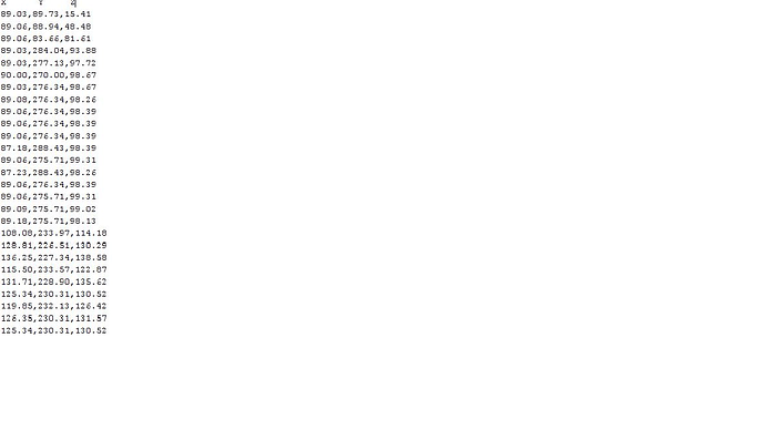

Hello all,
I am currently doing a project which includes the accelerometer ADXL335. I have got the code from this site and it worked pretty well. But i am unable to understand the output. What does it represents in degrees? Does it represent anything related to gravity?
My code is :

My output is attached below
Looking forward to hear from you,
Regards,
Koduri
That program is intended to calculate tilt angles, but is partly nonsense. You should ignore it.

Hello,
I got the x,y,z reading with respective to "g". The thing is i have placed the accelerometer on the tip of the index finger . Now i am doing a test in which i will tap the index finger on to the thumb finger. I would like to find the distance between the index and thumb finger at respective time instants.
Is it possible?
Regards,
Koduri
Theoretically, it is possible. In practise, probably not.
