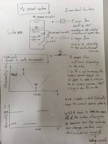

I have prepared two explanatory figures I think will give you a quite reasonable understanding about the current state of my tests and the problems I want to solve. Figures follow in the Google Drive link below:
https://drive.google.com/open?id=0BzgTiRaz6lg-T2F0ajFubDVoTFk
Stating it simply, I have one major problem:
I currently invert the current source polarity manually pressing a buton on the current source.
I'd like to automate this process using the voltage reads between the electrochemical capacitor poles as the input to determine when the polarity should be inverted. Shortly: 700mV (reverse it), 0mV (reverse it back).
Why so? Cause I want to run these experiments for several hours, maybe days to see how the capacitor performance changes over time and each cycle of Charge-Discharge actually needs to be manually switched.
Should it be 700mV exactly? Yes, cause my supercapacitor system involves electrochemical reactions that should be avoided.

As all this is a part of a masters degree which involves analytical measurements, I need to have signal precision, accuracy and robustness. Sadly I have just one of the Keythley current/voltage sources in my lab at the moment.
Consider that I take voltage readings of 0.0000V precision each 10ms.

Just had a closer look at your circuit.
I'm puzzled. You have an adjustable resistor in series with the capacitor , and measure the voltage across it - presumably to determine the current.
And then drive it with a constant current source/sink.
So this voltmeter will show a constant value depending on the constant I setting according to V = IR.
The other voltmeter will show the increasing / decreasing voltage across the capacitor, which will vary as
C dv/dt = I.
Presumably you want to see how the capacitance varies with applied voltage by logging dv/dt - am I right?
And how that value changes after many cycles?
And you could also infer the capacitor's internal resistance by looking at the voltage jump as the current is reversed?
