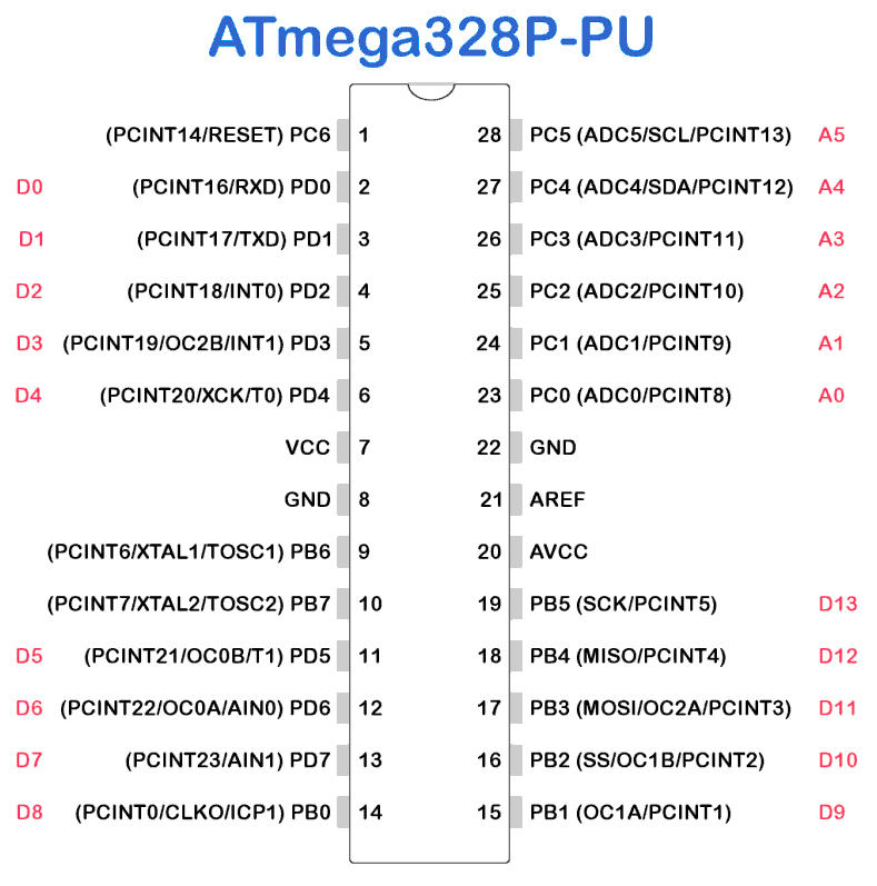

What is the purpose of an icp pin? I find little documentation for it, and oddly the pin use is different between uno and mega. (I thought they were 100% compatible in terms of matching pins)

  • Look at the controller data sheet.
    Input capture pin.
    The Input Capture Register can capture the Timer/Counter value when a change of the logic level (an event) occurs.
Also, they've become the default place for SPI peripherals to connect to those signals.

As others have mentioned the icp is (Input Capture Pin). While there may be additional uses, the ones I'm most familiar is for an:
Input that causes a timer or other hardware device to act. For instance, a timer might be setup to measure the time of a pulse. As the timer is counting a signal on that timer's ICP would stop the counter so the software can read the timer counts (aka pulse time).

So ICP sounds like a standard interrupt pin that captures rising and falling edges, but with an internal timer that captures the time since the last change.
So it might be good to determine a pulse width turning into a 1 or 0.
Chapter 15.6 of the Atmega328p datasheet explains the mechanism of the Input Capture Unit of the 16 Bit Timer1.

3. If you are referring to alternate signal of Pin-14 (Fig-1) of the ATmega328P MCU of the UNO, then the signal is: ICP1 (NOT ICP). The purpose of the pin is mentioned in post #5 and its details programming can be found in data sheets. Do you want an Example?
Figure-1:

You might have noticed that there are two wildly different sets of answers showing up.
Are you talking about the connector labeled ICSP on the arduino boards, or the ICP1 pin described the the ATmega328 datasheet (but not used in usual Arduino code)?
I was referring to the later: The icp1 pin. It's not really clearly documented in most references. I understand it better after looking at the sample code.

From that post: It looks like you can configure things so that every time ICP1 changes state, the timer1 count at that time is copied to the "input capture register." Then you can read the register and get a time that the pin change occurred, potentially at a greater precision than you could in a SW loop looking at the pin...
