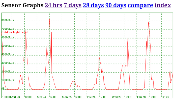

In my project that used a BH1750, I used the type of module with a circular shape that fits into a hemispherical dome of translucent white plastic. This dome reduces the light level, so it is necessary to adjust the readings to compensate for that. The dome protects the sensor from strong sunlight, to some extent, and also diffuses the sunlight so that the angle of the sun to the sensor has less effect on the readings.
I didn't have a luxmeter to calibrate my BH1750, but I was able to compensate for the dome by measuring the light level at a fixed position under a desk lamp, taking readings with and without the dome covering the sensor.

I have not compensated for the 1.2 factor you mentioned. I have compensated for the reducing effect of the dome, and that was a similar amount. But I have no other light meter to check the results against, so I can't know for sure if my readings are correct or not correct.
I have read that sunlight can be up to 100,000 lux, so if your readings are less than that on sunny summer days around noon, maybe you need to compensate for the 1.2 factor.

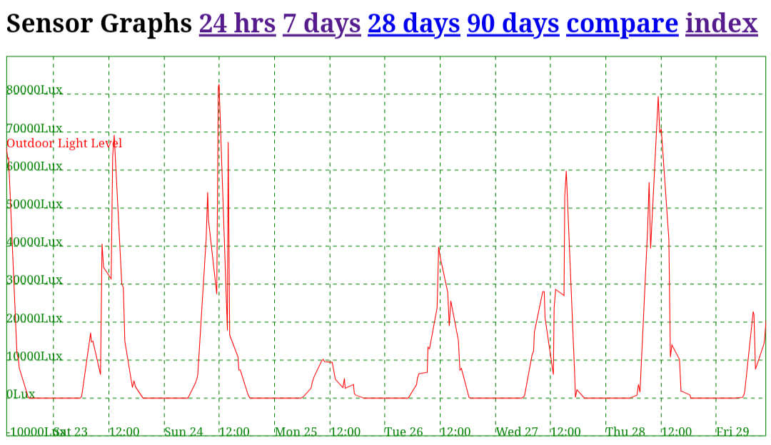

Below you can see my readings over the last week. They peak over 80,000lux. If I compensated for the 1.2 factor, my readings would exceed 100,000 lux, which would not seem correct for northern England in March.
