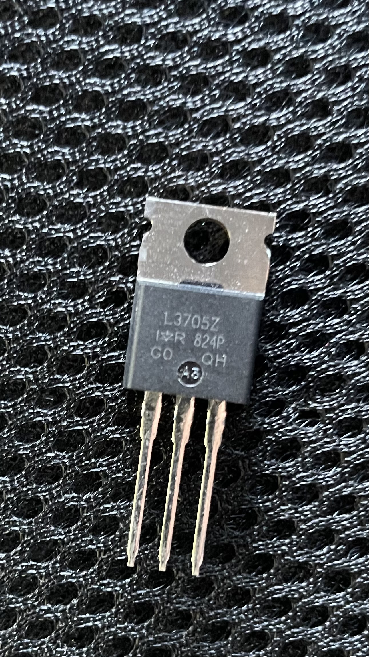

I was going to run 9-20v through it, controlled by 3.3v. But I don't know what limitations the difference between N and Z(I have it) series imposes (what resistors to use, and whether this model can handle such a load)

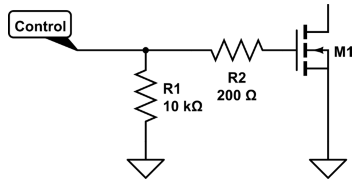

You have not said what load you will be controlling (ie how many amps of current). Since you will be using 3.3 volt control logic the N option seems appropriate. 20 volts is not a problem as both options can handle up to 55 volts. As for the gate resistors, see the picture for reference.

I made a working circuit with 9V battery, 500mA motor and IRL3705Z, the only one thing is heating - IMS1117:
*I was just too lazy to get out the Arduino Nano, it’s not connected to anything.
