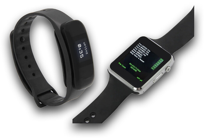

look at lilygo wearables
at least you would not have to worry about the design, the battery etc and you can focus on the coding
