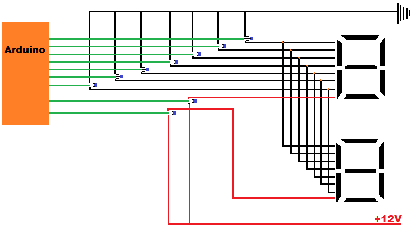

Ok so I am making a big seven segment display. This display will consist of 4 digits (4X seven segment displays) but I will be multiplexing them so one will only be on at any point in time.
The LED's I'm using have a forward voltage drop of 2.5v and are recommended to run at 20mA.
Each segment of each seven segment display will have 12LED's. So one seven segment display will contain. (7x12)+4. The 4 is for the decimal point. In Total it will contain 88 LED's.
In each Segment I will have 3 parallel lines each containing 4 LED's. Each parallel line will have a 100 OHM resister to "burn" the excess 2volts to keep current at 20mA.
So each segment will have a resistance of about 30 OHMs. For one seven segment display the resistance will be 4.7ohms. So basically one seven segment display supplied with 12v will draw 2.5amps when all 7 segments are turned on.
I will supply this displays power with a car battery which could easily handle 2.5 amps.
Firstly are my calculations correct?
And Secondly I plan to control this display with an arduino uno. So will I need transistors or relays to control this? Do you get transistors that can handle 2.5Amps?
I have Bc 547's which have a max voltage of 60v and 100mA which will definitely not work so what transistors can I use? Or must I use transistors and relays?
Thanx for any help

The picture i have attached is what i want to do and by the looks of this and what you guys are telling me is that it wont work without some hectic use of electrical engineering knowledge and chips and stuff :(. Im sorry i am very frustrated but i think i jumped in too deep with this being my first project ever. I started reading up about electronics like 4 weeks ago. So i apologize if i seam aggressive, you guys are just way too knowledgeable on this unlike me. With the knowledge i have i want to just simply use transistors like in my diagram but i guess i cant and i dont know why it cant work but anyways. The display is common anode, that is all the positive leads are connected and displays are switched by switching the corresponding ground. I only drew 2 SSD's but there are actually 4. But two explains the cuircuit
Ok i am a bit confused and i think my drawing is wrong but it still explains what i wana do with the transistors. When i wired my arduino directly to the small SSD's all the grounds of the four displays went into 4 different pins. Then the 7 positive leads went into 7 pins on the arduino. So if i wanted to switch display 1 on i will set the ground as low and the the positive pins as high according to which number i want to display.
calvingloster:
So your display is wired as common cathode. If you keep it that way, then you need 8 level-shifting high side drivers, and 4 of the simpler low-side drivers. If you wire your new display as common anode instead, then you need 4 level-shifting high side drivers and 4 low-side drivers.

What you have is fine, and you are definitely on the right track.
For the common anodes you need PNP, or P-channel MOSFETs.
You will turn on one common anode at a time.
For the parallel segments, you need NPN, or N-channel MOSFETs.
You will turn on the NPNs for the digit you want displayed.
Now here's the tricky part: PNP, or P-channel MOSFETs, need their control pin pulled low to turn them on, and high to turn them off. High in this case means 12V.
To do that, you will have a resistor from 12V to the control pin.
The arduino output pin can't go to 12V, tho, so the arduino will control an NPN transistor, and that will pull the PNP/P-Channel control pin low.
NPN emitter connects to Gnd, collecter to PNP/P-Channel - high from Arduino into NPN turns it on, which bring collector low and turns on the anode supply pin.

Thanx that makes sense, although I don't understand why I must put a resister between the 12v and the control pin?
The NPN collector can't drive the PNP/P-channel pin High - it can only pull low. The resistor pulls it high when the NPN is not pulling it low.
