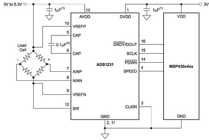

The best quality and easiest way to do what you want is to use something like the ADS1231 (http://www.ti.com/lit/ds/symlink/ads1231.pdf)
It would be used in a circuit similar to the image below.
The connection is ratiometric so the quality of the top rail (like the Arduino 5V or 3.3V) is not important.

Sorry it was a typo, should have been ratiometric.
This means that the stimulus at the top of the bridge is also the positive reference to the ADC and the connection at the bottom of the bridge is the negative reference for the ADC.
This way the ADC always has the same reference range as the voltage actually applied to the bridge.
This ensures that the delta from the bridge output remains the same number of code regardless of variance in the top rail.
The noise on the rail could propagate through but this device has very good filtering combined with the low pass filtering that is part of the Delta Sigma ADC.

Ok, now that makes sense. The measurement error due to variance in stimulus voltage is neutralized because the measurement is with respect to the stimulus supply, a change in supply voltage results in a change in measurement in the opposite direction neutralizing the error ?
