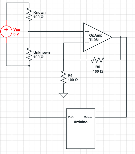

If I understand what you are saying, are you suggesting something like this? Ignore the resistance values or the name of the opamp. If I understand opamps correctly, the values of r4 and r5 will be able to dictate how much I boost the value of the voltage recorded.
Yes, except that the Arduino is reversed - The output of the Op Amp needs to go to A0, and the lower side of Unknown needs to go to the Arduino ground. Known R is 470, Unknown is your 0.5 to 3 ohm. So roughly 5mV with 0.5 ohms, 30mV with 3 ohms.
Then two Op Amp sections wired up as non-inverting as shown. R4 1k, R5 10k gives you a gain of 11 in a noninverting configuration. Or you could get a 9.1k resistor for R5. Then follow it with another Op Amp wired the same way.
So the first Op Amp then puts out 50mV at 0.5 ohms, and 300mV at 3 ohms. Second Op Amp puts out 500mV at 0.5 ohms, and 3V at 3 ohms.

Steve that circuit has issues, perhaps only pin 3 and ground swaped on the Arduino.

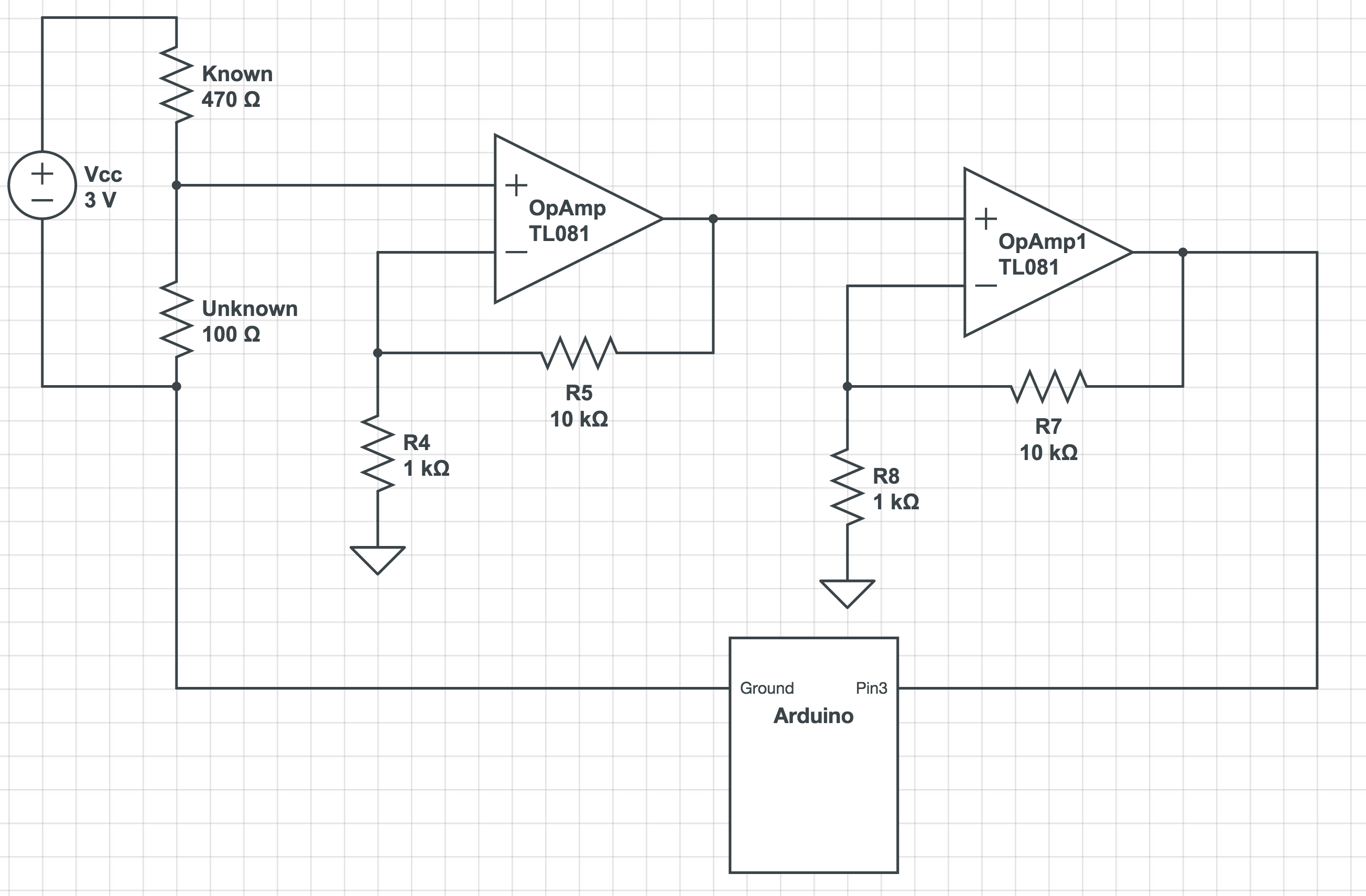

How about this:
Link in case the image doesn't work: Imgur: The magic of the Internet
Mastermind, the circuit you have drawn gives you 0.5 V across the 100 ohm resistor. The output of the second op amp is thus trying to be 50 V which it can't do! With your 3 ohm resistor there though it should work.
Why not use the 5 V Vcc from the Arduino and change the 470 ohm resistor to 47? Then you could just use one 10 x gain op amp stage.
You will need +ve and -ve supply rails for those op amps.

OK, so is the Arduino running from 3V? That's fine. Using 3V also to supply current through the 470 ohm resistor means the voltage is scaled down, too. 19mV at 3 ohms will result in about 2V at the output of the second Op Amp stage.

You use two Op Amps because generally you don't want to try and get a voltage gain of 100 in one stage. It is simple enough to use two Op Amp stages.
The TL081 will not work unless you supply it with at least +5V -and- -5V. It is not rail-to-rail, nor is it well suited to a single supply low voltage.
http://www.ti.com/lit/ds/snosbw6a/snosbw6a.pdf
The ubiquitous LM324 is not well suited, as the output can only go to a voltage 1.5V below the supply voltage. You should pick out a RRIO Op Amp, something rated to run down to 2.5V single supply voltage. It doesn't have to be fast.
