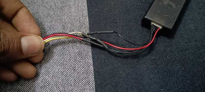

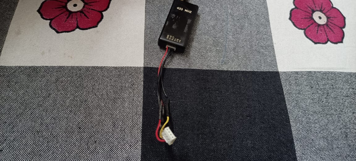

hi, Jimit here, I want to send flight data through telemetry via Serial connection, but when I receive on telemetry my pc, I got weird data, that data I show is not in a proper format. I don't know how to deal with it.please help me

If run a 10Hz program it runs perfectly! so no solution for high-rate data transfer? I use Teensy 4.1 controller for my drone where I Use Serial4! above I give My full of code! are you want to check IMU code? so I can not run my code at faster rate?

It could be that the receiver or the telemetry channel can't handle the data rate.
As-is, it's a tradeoff between precision or reliability. One way forward is to encode your data: ASCII strings are wasteful. Three full Uno floats would encode into a short base64 string like "2w9JQNsPSUDbD0lA"

Hi dev bro, I run telemetry in my laptop using USB port, actually I use both usb port, then using python I send one telemetry to other at 100hz, I get expected output without any problem, but only problem in Arduino, any solution?
When you use USB-only links, it just pretends to have a baud rate, with the data delivered behind the scenes in USB packets.
