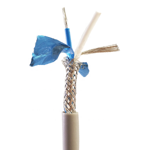

A shield is only a shield if ONE end is connected to the ground or common connection used by your project. If both ends are connected, it becomes a conductor, not a shield. I hope your RS-485 cable has a separate wire that connects the grounds at each end for RS-485.
Your weather station should ultimately have a real earth ground through the power supply connected to the mains power. But if not, should still operate ok.

If it is outside be sure the shield (drain) is connected to earth ground only at one end the other open. When you get sparks in the sky guess where they want to go and how they will get there. EMI will die when buried in the ground as well. I can only guess as I do not know what it looks like or where it is going to be mounted. I did all my outside sensors wireless so that eliminated the problem with sky sparks blowing stuff up but it still causes communication interruptions.

Thanks for your reply, this is what my cable looks like, it consists of 2 cable for A and B and a shield that wraps them. and the shield is what im going to ground to the earth ground (i think) but i've seen some PowerMeter that use RS-485 has a terminal called shield, i wonder where does this terminal connected to because i don't have any on my own.
