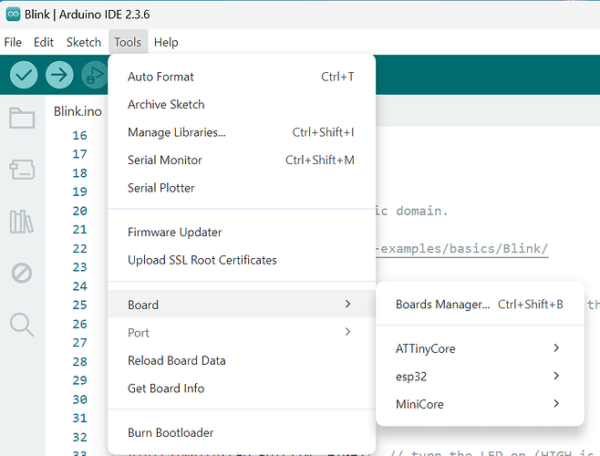

I just notice that I have no AVR Boards to select.
Where are they?

You can install the "Arduino AVR Boards" platform via the Arduino IDE Boards Manager. I'll provide instructions you can follow to do that:
  1. Select Tools > Board > Boards Manager... from the Arduino IDE menus to open the "Boards Manager" view in the left side panel.
  2. Find the "Arduino AVR Boards" entry in the list of boards platforms.
  3. Click the "INSTALL" button at the bottom of the entry.
  4. Wait for the installation process to finish, as indicated by a notification at the bottom right corner of the Arduino IDE window:
    Successfully installed platform ...
You should now see the boards of the "Arduino AVR Boards" platform under the Tools > Board menu in Arduino IDE.

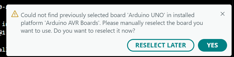

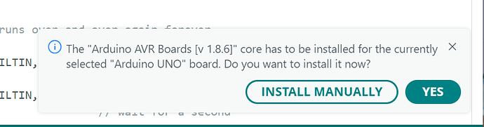

When I open the IDE 2.3.6 again I saw this message below and just clicked on YES.
Then I selected Arduino UNO and the AVR Boards is back.
