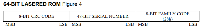

A: Let us perform this Tutorial-A using DS18B20 Digital Temperature Sensor and OneWire.h Library
1. Connect the DS18B20 sensor with UNO as per following diagram.
Figure-1: Connection diagram between UNO and DS18B20 sensor
Figure-2: 64-bit ROMCode/Address of DS18B20
Figure-3: Scratchpad Memory map and ROMCode?address of DS18B20 sensor
Functional Description of Fig-2, 3: Every DS18B20 chip has its own 64-bit (8-byte) ROMCode (Fig-2) which is composed of three fields viz., 8-bit Family Code (0 - 7), 48-bit Serial Number/Address (8 - 55), and 8-bit CRC Code (56 - 63). Lower 2-byte (byte0, byte1) of the 9-byte wide scratchpad memory (Fig-3) contains the temperature information, which are always updated following every temperature conversion command. The user program reads all the data bytes of the scratchpad memory and processes the lower two bytes (as per Fig-4) to extract temperature value in decimal format.
