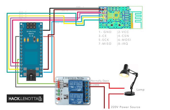

I am planning to have Arduino Uno + Ethernet Shield + nRF24L01+ transiever as control point (sends out commands, hosts a website) and little arduino+transiever systems around the house.
I understand that there is no problem with connecting Arduino UNO with nRF24L01+, so there is no problem with that.
I want to make a node by connecting Arduino NANO and nRF24L01+ which could be inserted everywhere necessary. For example, behind the light switch, so it would receive a command from Arduino UNO, then it would execute the comand and send back the state of the light switch.
But i read that if Arduino Nano is powered by external power source then there is no power to 3.3V pin? And even if there was a possibility to power NANO with USB, the 3.3V pin will only provide 50mA which is barely sufficient to operate nRF24L01+?
Maybe there is an arduino board which is more suitable for my goal or it is possible to make it work with Arduino Nano too?
Oh, and here is an approximate picture of the nodes i want to make.
Thanks!
Long, long time ago, there was a version of the Nano that used the 3.3V of the usb chip and that chip was not powered when the usb was not connected. That has changed with newer versions. You can always use the 3.3V.
There are more errors on the Arduino site, and I found it impossible to get those corrected =(
The 50mA is however a problem. Perhaps the Pro Mini has just enough power to do that. The Pro Mini has a real voltage regulator for the 3.3V, but it has no usb connection.
What about the Micro ? (The miniature version of the Leonard).
You can use a 5V Nano with an nRF24L01+ without any problems, as long as you remember to power the RF24 from the 3.3V pin. However, the range of these un-amplified transceivers is relatively poor in my experience and I wouldn't expect them to communicate across a typical house, so check the range you can get before you commit to this solution. There are some Arduino clones with integral WiFi which cost more but might be a more reliable basis for your project. Also consider buying an X10 solution before you commit to making your own equivalent.

Oh, now i get it. On the Arduino site it says one thing, but people who are using Arduino Nano for their projects say that everything is working fine with external power source, so that got me confused.
