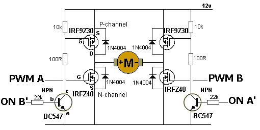

Which h bridge circuit is more suitable for my dc motor.
I have a 24V, 3.5A dc motor. Which circuit would works best for my motor? 4 NPN transistor or 2 PNP and 2 NPN transistor?

The second design only works at 5V so is unsuitable for your 24V motor.
It looks like the first design also only works at 5V so neither is suitable for your 24V motor.
Is that 3.5A stall current, full-load current or no-load current?

Ok. What if i change it to 24V. Which circuit would be perfect for my motor?

The rated current is 3.5A. Stall current is 17A.

Hi, Jimmy, both of those circuits you posted will not work with 24V because of the biasing needed to turn the transistors ON and OFF, particularly the PNP transistors or any in the positive supply side.
Take Willyboielectro's advice and look up how to use L293DNE, although I'm not sure of its current spec.

How do you expect a L293 to cope with the 17A stall current then? It's rated at 0.6A
These current levels need a MOSFET bridge, no question. Some of the Pololu ones
are probably up to it.

What if i use a darlington transistor? BDV66B and BDV67B.
Hi, its not the component specs that is the problem with that circuit.
It is the circuit component configuration/layout.
Tom..... :slight_smile:

Then how can i modified the circuit?

Im doing school project. My task is to design and fabricate a motor driver for my motor.
what type of h bridge circuit can work for my 24V dc motor?
motor specs - rated current is 3.5A. Stall current is 17A.

Do you understand how to drive an H-BRIDGE ?
1-Do you know how to control the on, off , forward, reverse ?
2-Do you know how to control the speed ?
3-Do you have ANY electronics experience ?
4-How much are you willing to spend ?

If you want to build it yourself , see attached schematics and datasheet.
I recommend the RFP30NO6LE MOSFET (60V, 30A), LOGIC LEVEL TYPE
You will need GOOD TO-220 heatsinks:
You will have to drill and tap a 4-40 thread hole in the heatsink as it does not come with a hole.
The drill bit and tap are sold together and you just need a centerpunch and a drill to do it.
It's not rocket science. With four of the mosfets I recommended , with the heat sinks linked , it should meet your requirements.
One minor note. Don't forget to buy a small tube of thermal paste at Radioshack when you buy the heatsinks (or order them online on their website).

OK, so the problem is that both of the original circuits are wrong. Sadly, you require a level of design skill even to pick out good from awful suggestions on the Internet.
Here's a proper one, with a good tutorial on the page.
Addendum: Even then, I'm not so sure about it ...
That's why they make ICs especially for the purpose.
