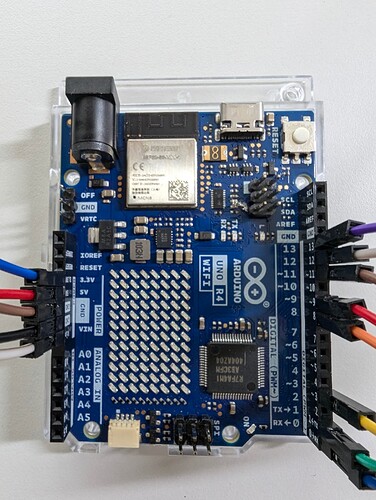

Which pins are actually needed for 'Motor Shield Rev3'
I have a Uno R4 WiFi and want to connect it to a 'Motor Shield Rev3', but I don't want to mount it on top for two reasons:
  1. I don't need the Brake and Direction pins. I can fix them Low on the shield and use the corresponding pins on the Arduino for other things
  2. It hides the LED Matrix on the R4
How do I know which pins I need to connect between the Uno and the shield?
Is there a doc for the shield that tells me?
Here's what I know for my project:
A0&A1 return the current usage for my motors
A2-A5 unused?
Vin/GND/5V/3.3V I can connect up
RESET - Could I connnect this to an unused digital input on the Arduino (not RESET) and make it so the shield reset does a different function in the code, say stop the motors, but not reset the board?
IOREF and the blank pin next to it, are they needed by the shield?
0-1 TX&RX are these needed by the shield?
2 unused
3 My Left PWM
4-7 unused
8&9 Brakes I can set low on the shield for always off
10 I'm using for a Servo
11 Right PWM
12&13 Direction I can set low on the shield, no change of direction
GND I can connect up
AREF, SDA & SCL are these needed?
That all looks quite complicated, so maybe I won't do it, but could/should it be done?

The LSP1-4 pins are the driver outputs connectors. LSP5-6 is the power connector for the L298 and the motors. With UMDT you probably mean VMOT which would be the 12V supply voltage.
The Vin is connected to the VMOT and can be used to power the Arduino microcontroller board. If you don't want that, cut the trace.
Pins D0, D1, D2, D4 and D10 are not used by the shield; see JLOW and JHIGH headers in the schematic. D5 / D6, A2, A3 and the I2C pins are not used by the shield electronics and available on the dedicated headers.
The reset is only a convenience button because the shield will make it difficult to reach the reset button on the Arduino microcontroller board.
Not 100% sure if I left any unnecessary connection, but with these pins connected it works for me now (also powering the arduino via the motor shield).
