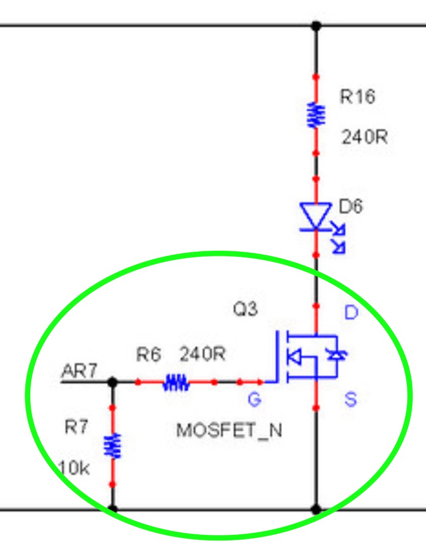

I think it will work fine. I’m assuming the ATtiny85 is running at 5V and that its ground is connected to the power ground. I also assume C3 and C4 are across the PWM outputs. I’d recommend not using them, as they could cause excessive current drain through the MOSFET when turning on. Some of the part numbers in the schematic are for sockets rather than MOSFETs. You did a good job with the bypass capacitors.
For reliable operation, make sure the 24V supply cannot exceed 30V under any fault condition; otherwise, your regulator and MOSFETs could be damaged. You might also consider using two capacitors on both the input and output of the regulator. If one fails, the system won’t be affected.
  • The 7805 is close to the input voltage maximum of its range.
  • The AO3400 can sink 5A at Vgs = 5v.
  • The MOSFET circuit should look like this:

Thanks Larry, I'm pretty new to this but what it looks like is that the pull down resistor connecting the gate and source should be after the gate resistor. Is that what you're referring to? As you may have seen I updated the post with the latest schematic. I did these edits before you replied though so my layout is essentially the same. Everything I was reading was describing the pull down resistor being placed closer to the mosfet than the gate resistor.
The 10k pull down resistor is there for the Arduino pin, not for the FET.
It keeps the pin firmly grounded during boot, when the pin is still an input.
