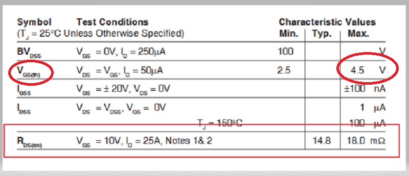

The good news is that this transistor (MOSFET) that you posted in the datasheet only only need 100 nA (nano amps) as a gate current.
GSS VGS =  100 nA
Another good news is that it has a maximum Vgs of 4.5V, which means it should work well with a 5V arduino.
VGS(th) VDS = VGS, 4.5 V
See suggested scheme below.

Look closer;
The parameter is Vgs(threshold) = 4.5V
That is when the gate starts to get the MOSFET to conduct, NOT FULLY conduct.
IXTP60N10T is not a logic level MOSFET.
Probably like this using an opto coupler as a level shifter:
Indeed it is not. The highlighted RDS(on) quoted at no lower than 10 volts makes that clear.

Thank you to all for your advice : i learned a lot on reading transistor data sheets!
  • using opto-coupler to separate arduino from the rest : found this one : https://www.farnell.com/datasheets/91015.pdf
  • Rds(on) is usefull to calculate power dissipation in the transitor :
    P=Rds(on)* I²
    5Watts would need a heatsink to dissipate properly i guess.
  • Pay attention to supply enough Voltage to the gate to exceed Vgs(th) in order to fully "open" the transistor
  • pay attention to supply enough current to the gate so it charges up correctly (Igss) (seems to be no issue when values are below 20mA for arduino, but this does not matter when using an optocoupler that has it's own power supply for the emmitter
  • pay attention to the absolute maximum ratings : Idrain (max) : which is 53Amp for the https://www.farnell.com/datasheets/2616977.pdf at 10Volts,

The Mosfet: IRLB3034PbF mentioned in post #12 looks good for direct drive by a 5 volt Arduino pin and has a very low RDS(on), quoted at 4.5 volts, of 1.7mOhms. This should dissipate less than 0.5 watts at 15 amps. You can then use a simple circuit similar to the one in post #2

The IRFB7437PbF is similar to the IRLB3034PbF but, in exactly the area important for your application, not good enough. Look at the voltage at which the RDS(on) is quoted. It is 6 volts. Don’t even imagine some sort of linear interpolation between this 6 volts and the 5 volts you can drive it at directly with an Arduino of the Uno/Nano caliber. That resistance is critical to you. Every 4 mOhms means another watt to dissipate. If, however, you use the opto coupler circuit which effectively delivers 12volts to the mosfet gate, there is no problem with any of the mosfet options so far seen in that they are all within in specification but still go for the lowest resistance ones to avoid heat generation.
